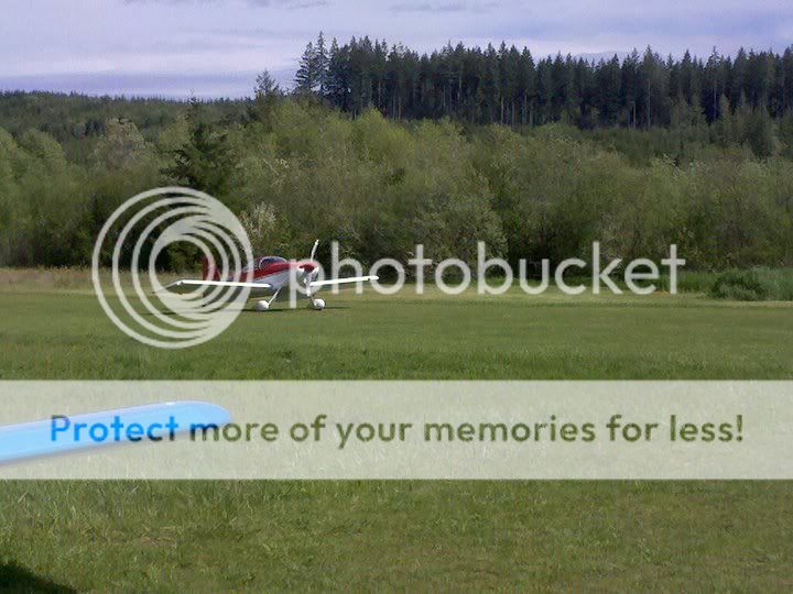

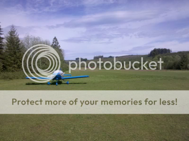

I just spent 3 days with Mike Seager in Oregon. The grass strip we flew off of looks beautiful and in great shape. But was rough enough to bounce us in the air on roll out. I was flying 477RV a taildragging -7, but noticed the blue -6a looked to be a pretty good shape. No nosewheel damage that I could see;). Maybe Mike is just lucky, but I'd wager money it's technique. Give him a call, he'll be straight up with you. If you want to know about flying RV's, Mike is the man.
Vernonia Airport midfield looking west
my trusty steed for 3 days
