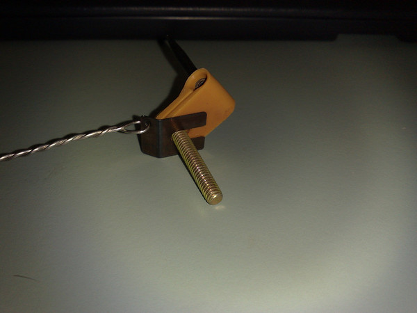

Gerry, At work in the tool crib, we have a little "U" shaped shim with a lip on the back edge. The idea is you put the #10 screw, into the compressed clamp, then slide "slotted shim" into the first thread below the shank of the screw. This will hold the clamp compressed on the screw. Then install the screw into the anchor nut a couple of threads, and pull the shim out from between the clamp and anchornut by gripping the lip with a pair of longnose pliers. I am trying to find out what they are called and where to purchase them from. The other method we commonly use, is the lockwire method around the clamp as suggested by jte65. Someone else may be able to help as to where to get these clips from. Goodluck..... Marcus.
Gerry, At work in the tool crib, we have a little "U" shaped shim with a lip on the back edge. ... I am trying to find out what they are called and where to purchase them from. ... Goodluck..... Marcus.

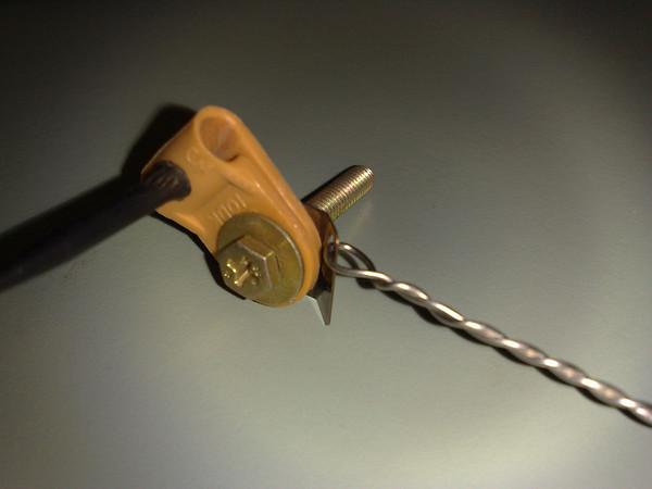

Sorry Bubblehead, I am currently in Singapore, and wont be back in the Hangar until the end of January. I rang the Toolcrib and he told me these clips are called CLIPITS. I have searched the internet in vain, so I dont have a picture. Best I can describe it. Bend a hacksaw blade until it snaps. You now have half a hacksaw blade with a bent up area at one end. This bent area is what you grip with your long nose pliers to pull it out once the thread is started. Cut the other end off square about 1" long. Cut a 1/2" long slot longditudinally into the square end. Taper the slot from about .200" down to .180" in the throat. (a very slight taper:)). Remove the jagged teeth, and deburr it. This will fit nicely onto a 10/32 screw. You can make ones with a smaller slot for 8/32, 6/32 etc. When I get home I will post photos and more details. Hope this helps... Marcus.

John, I have sent you an Email with the Pics. Didnt know how to post pics. If you can, please post the pics for all to see. Thanks Marcus.:)
Marcus emailed me two photos to show this little device which are posted below. I had not understood that slides over the bolt threads to hold the clamp shut. Very cool. Now we just need to find a source, although they look easy enough to make. These sort of remind me of some little clips used with automotive upholstery. Maybe there is something in that hobby/profession that could be adapted?
Thanks for the photos Marcus. They helped a lot.
