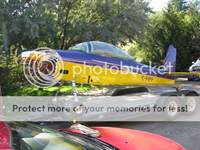

I made a trailer, sized it to fit the footprint of my RV 10.

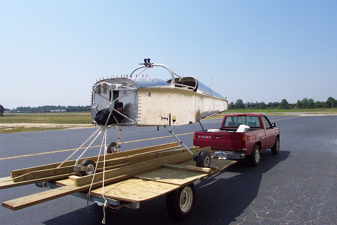

I used a combination of what Mike and Bert did on their transporting. I have a 4 X 8 utility trailer rated for around 1200 lbs. I measured where the gear would position on the trailer and built an outrigger setup with 2 X 12 boards 92 inches wide. I then boxed in the gear with 2 X 8's and used additional straps around the tires. I used tie downs off the engine mount and off the steps. My brother followed me as a chase vehicle with the wings in their cradle on his 5 X 12 utility trailer (he has welded rails on his - not useful for geared fuselage). I hauled it without any problems at all. Wasn't idea but it worked. $60 in material. Saving all lumber for when we will move the RV12 that we are starting on when its time comes. I did have a couple places on the steps that paint chipped off due to the tie down hooks eating through the foam I had on them. 60 miles through mostly two lane roads.
The normal 8 minute drive took 25 minutes. Got a lot of stares during the move. Had my wife following close behind me the whole way.
