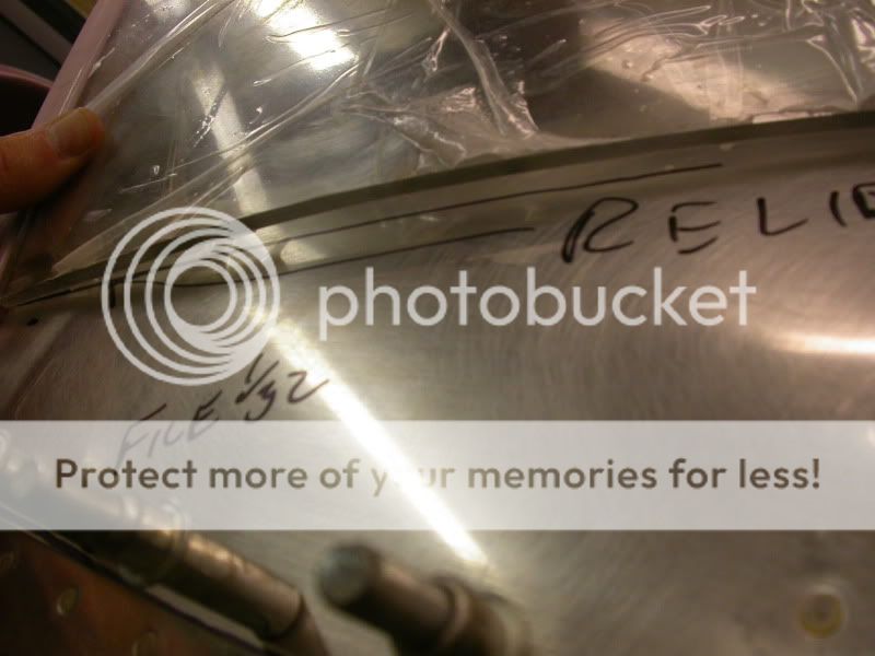

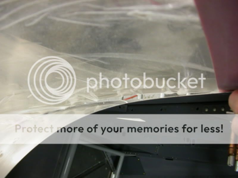

Bringing back an old thread. ... So I kept my Van's supplied windows mostly because I already had them when I first heard there were issues with the fit. And honestly, I had very little trouble trimming them down. Took some time, but I got them to fit very nicely. The rear windows and door windows are glued in and fit really well. Last night I glued in the windscreen. As others have found there is a bulge on the lower right side. Not as bad as I think some have described, but there. I just didn't notice anything off during the fitting process.
Just forward of the passenger door it's good: nice and tight against the side. But an inch ahead of that and for a 14 inch length it gradually bulges out and then back in. At its worst it's 7/32" away from the fuse.
I had planned to do the windscreen base fairing tonight but first I'm wondering if anyone can offer advice on how to fix this. (And getting a new windscreen from Cee-Bailey isn't an option for me at this point). I know this is a well documented issue but I can't seem to find anyone describing how they fixed it.

First off- Yes I helped with the shaping of the front windscreen only. I am local to Desser and I offered my windscreen for the satistaction that I would get a custom fit windscreen. SO in my case I have a perfect fitting windscreen. I have stock side (door and rear) from Vans and they are fine-If there is confusion about the "as is" fit, it is slightly larger to allow for custom shaping so no one should expect a perfect fit without some minor adjustments. but there is a huge difference between the CB and Vans fit. We all seem to have that bulge in the lower right windscreen, I find it hard to believe that Vans hasn't fixed that after so many people having this issue. Before I tossed my Vans and installed the CB I used a heatgun on the bulge. Using pressure to squeeze the plexi flush(er) I heated the plexi, as it gets softer it tends to move a little easier. its a slow process and eventually the plexi will flatten out.

The plans describe three clips that are pop-riveted into place to hold the lower windscreen. I added a few more of these clips in the area of the bulge to pull it in. As I mention in the post above, it took a lot of pressure to pull it in, and I'm not happy with this fix and would not do it again....if those clips ever let go, I bet the fiberglass fairing pops off, and I don't even want to think about that. But, I had a larger bulge than you, and this fix may be appropriate for a smaller gap requiring less pressure. I guess it is really just a matter of using enough rivets....you could fabricate a long continuous clip plate to make the mechanical bond.
The plans describe three clips that are pop-riveted into place to hold the lower windscreen. I added a few more of these clips in the area of the bulge to pull it in. ... But, I had a larger bulge than you, and this fix may be appropriate for a smaller gap requiring less pressure. I guess it is really just a matter of using enough rivets....you could fabricate a long continuous clip plate to make the mechanical bond.
I thought about doing something like this. One draw back is these rivet heads will be visible from the inside. Maybe no big deal. In the end and based on some advice I got privately I did nothing special. The bulge in my case is at its worst just under 1/4". I filled in the bulge area with epoxy/flox (dyed black) and followed the plans from there. I'm now in the process of sanding it all nice. I'm paying special attention to the right side and I'm already finding that it's not at all noticeable unless you're really looking for it while comparing to the left side. After I'm finished sanding and shaping I believe it will be hard to find there had been any issue.
If I had a do-over I'd go with the CB windscreen. No question. This has been a lot of unnecessary extra work and worry. As stated before it's very disappointing that Van's hasn't fixed this in the 10 years since it was first documented. They should simply use CB as the supplier and ditch however they're making their transparencies now.
