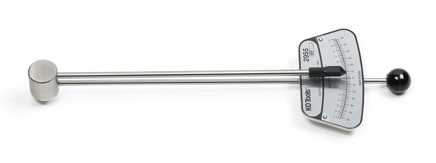

Measuring Running Torque
I bought one of these to measure the running torque on nuts. As Bob said in post #4, you add that torque to the specified torque. Example, you start to thread the nut on and when the bolt is more than a full thread through the locking region of the nut, but still not bottomed out, switch to this tool and measure what the torque is from just the locking element. Then add that to whatever is specified in the plans. Set your clicker to this sum or alternatively, simply continue to use this.
http://www.amazon.com/2955-Torque-Wrench-0-60-Inch-Pounds/dp/B00004SQ3B
Dave
IU bought a nice Park Tool (model TW-1) from the local bicycle shop. I use it just to test for rotational drag on a bolt and then use my regular 'clicking, head braking' torque wrench.
