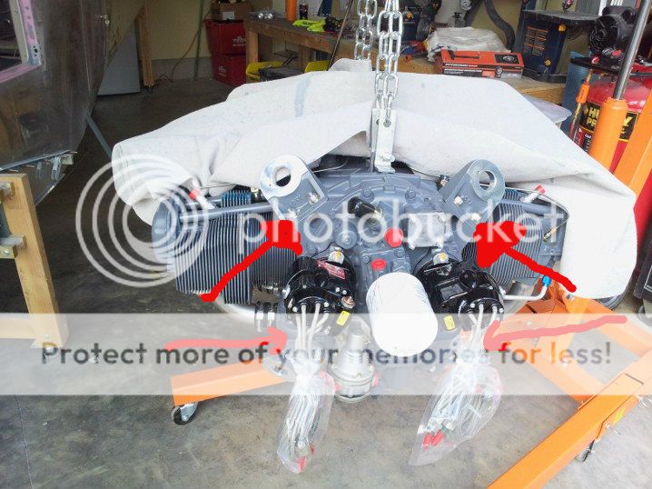

Anyone have hints or pictures on how they ever got a torque wrench in on the hardware to torque the nuts when installing the mounting ears on a factory lycoming engine? I can barely get my finger on these nuts, let alone torque wrench. The angle on these ears seems to it very difficult to get a socket or wrench in there even.
I looked at that and it looked dicey on the forward side of the ears near the cylinders. Almost a crow foot and a pivoting extension arm.
I seem to recall that I used a socket with a built-in universal joint. Not enough room for a conventional socket plus a universal, you need one built-in.
I used a 3/8" drive crowfoot with no problems but my ears were the nice machined billet aluminum ones from Aero In Stock.
Thanks. I verified a crow foot will fit. Just need to get a reverse adapter as my torque wrench is 1/4 and the crow is 3/8.
Borrow or, better still, buy a torque wrench with a 3/8" drive. The 1/4" drive is fine for AN3 and AN4 bolts but you'll want the heaver drive for working in the engine compartment. Also, eliminating as many adapters, etc., as possible is a plus when torquing; the play introduced can mess your results up.
Mine were already mounted, but looking at the photos, I wonder if a cylinder base wrench would work??
