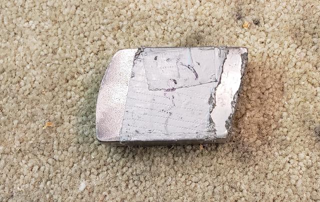

The below bucking bar did 90% of three airplanes. Years ago it was a standard in the Avery kit but I could not find anyone selling it. It is just the right shape to enhance control - using any of the various surfaces. If you can find one, get it.
Tape any surface on the various bucking bars not in use. This helps to prevent dings and makes the bar easier to hold. The tape on this bar is set up to buck the wing bottom skin rivets.

I humbly disagree with Carl about the tungsten bucking bars. My tool set came from Isham, and originally I only got the steel bucking bar set (I think it comes with 3 different types). Later, I bought a single, tungsten bucking bar that's about 1"x3/4"x3" and one end has an angle on it. I have used this tungsten bucking bar to buck every bucked rivet on RV-10 that came once I purchased it. My experience was the opposite from Carl. I find the mass of this bar to make it easier to hold in place than the steel ones. I also found that novices (aka my helpers) have an easier time with it too. Your mileage may vary. I just wanted to give you another data point.
I actually like heavier, physically larger steel bucking bars. The Unriens have long term loaned me their tungsten bar, but my favorites are some steel bars I made myself. If there is space, I find that a bigger, heavier bar is easier to steady. But a big bar becomes tiring if you're in an awkward position.
Ultimately, it comes down to individual preference. Use what works best for you.
Love my tungsten bar as well.
