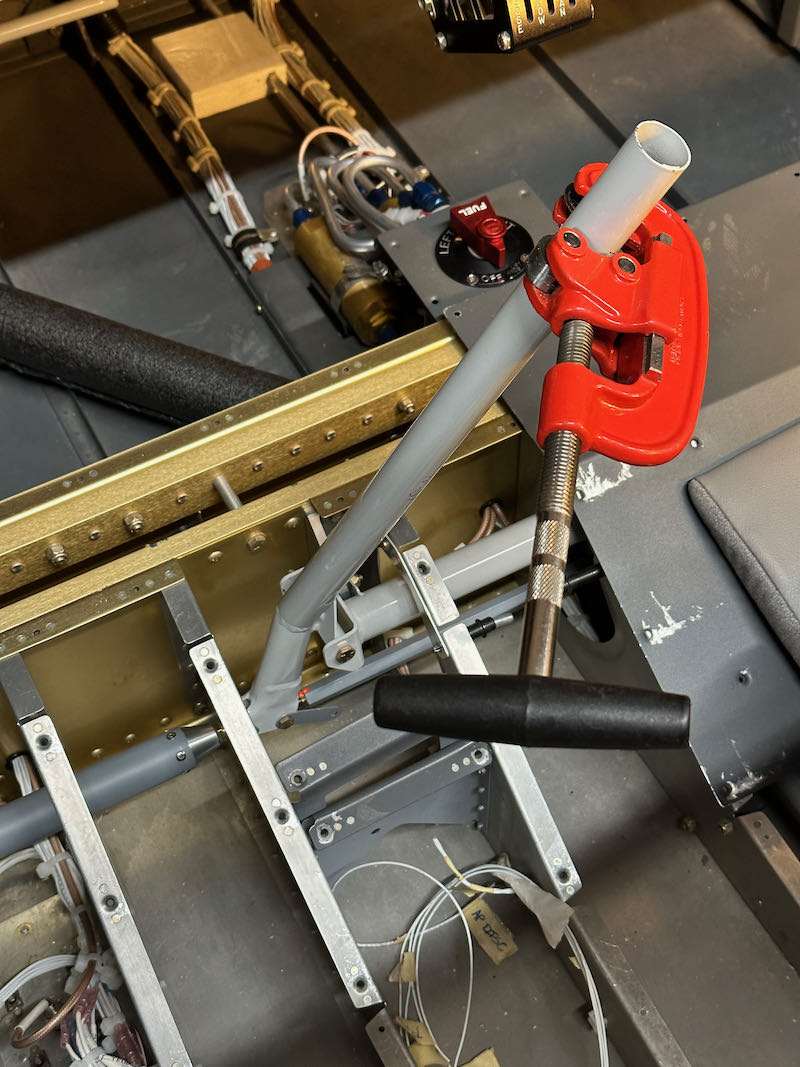

What did you use to cut your control stick? I only have a wood working band saw, hacksaw, steel chop saw, wood miter saw, wood table saw, jig saw…
The chop saw would be my choice IF it wasn’t already power coated. Now to keep it looking good I’m forced to use a cold cutting/saw blade technique.
I used a pipe/conduit cutter. Made for easy and precise cut, but did leave a pretty good burr on the inside that had to be filed to get my stick grip to fit.
I just used an old plumbing tube cutter. The steel will dull the cutting wheel so you don't want use a good one that youre going use for your fuel lines or whatever, but if you go slow it will do a nice square cut and not destroy the powder coat. The added benefit is that you can do it with the stick already installed if needed.

Wrap it with blue tape first. The cutter will cut through they tape no problem, but the tape will somewhat protect the powder coat. You may get some slight marking, but as long as the rollers are clean and you don't crank down the knob it won't be very much. I don't think I have a great picture, but you can kinda see what I did in my build log entry June 7th, 2022
Also, noahhl is correct, it leaves a pretty good burr on the inside. I just ran a chainsaw file in there to knock that down after

At least on the -8 you have to cut the control stick down to fit under the panel. It states that in the build manual. Also, if you are adding a grip, the grip itself adds length to the stick so the stick needs to be cut down just to keep the same overall length.
Yup, a pipe cutter can be used in situ... file away the burr and you're good to go.

Thats all well and good, but if you're adding a stick grip on top then you must cut it down by the height of whatever grip you're using just to end up at a net zero change in length and so that you can achieve full flight control travel without hitting the panel or throttle sector knobs.
To be able to add a tosten military grip I had to cut about 6.5" off so I could end up with the same length as where I started.
