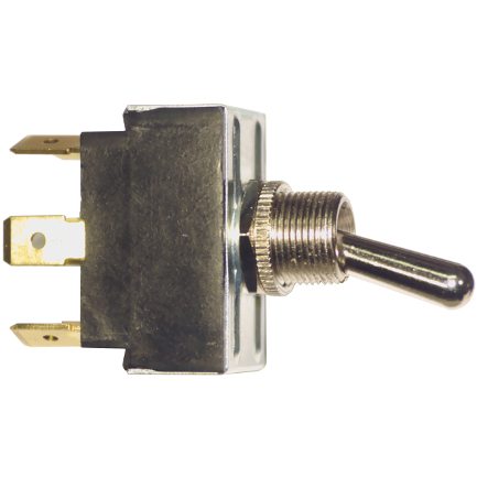

I used two Carling DPDT switches from Stein for my two ignition switches (SureFly on the left, non-impulse Slick on the right. Wired in such a way that the only way the start cycle can work is with the left switch on, right switch off, and the master switch on. Any other combination and the starter won’t engage. Impossible to engage the starter with the wrong ignition selected.

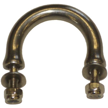

I protected the switches with guards from Stein:

Definately lever-lock style switches to avoid accidental tripping. Honeywell TL series switches are bullet-proof. Many options including off-on or off-on-mom like stated earlier. Available from any electronics supply house (Digikey, Mouser, Newark, etc).

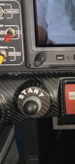

For those with the Aerosport carbon fiber panel; I'd bought the same red start switch and guard from Stein as Scott posted above. But I really wanted something labeled "Start" and I'm not a fan of the other style switch Stein sells.
A lot of the generic start switches online are labeled "Start/Stop." I wanted an OE quality switch only labeled "Start."
After some searching, I found this Start switch that was used on a variety of Can-Am products (Part# 710002594).
It fits the Aerosport panel like it was made for it.
