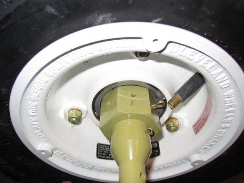

On the main wheel, with the factory tubes and wheels, I can't leave the caps on because there isn't adequate clearance with the cotter pin. This seems to be a problem when a fair number of RV-10s from the responses I got when I asked the question a few months ago.
Here's a photo:
That dimension is exactly..
......First one to tell me the dimension from the end of the valve stem to the outside of the wheel pant gets a new RV accessory free! Thanks,
Mike
......2 3/4" on the nosegear. I just measured it with my two attached valve stem extensions that I use to air it up.As Bob pointed out, the main gear tube stems point toward the axle unless you don't use Van's tubes and buy tubes that have the stem pointing toward the wheelpant, like the nosegear tube.

Could you get more clearance, by countersinking the cotter pin holes a bit, to let the head of the pin sit lower? Or, smacking the head of the pin a bit with a punch? I?d sure like to see a valve cap on there.
