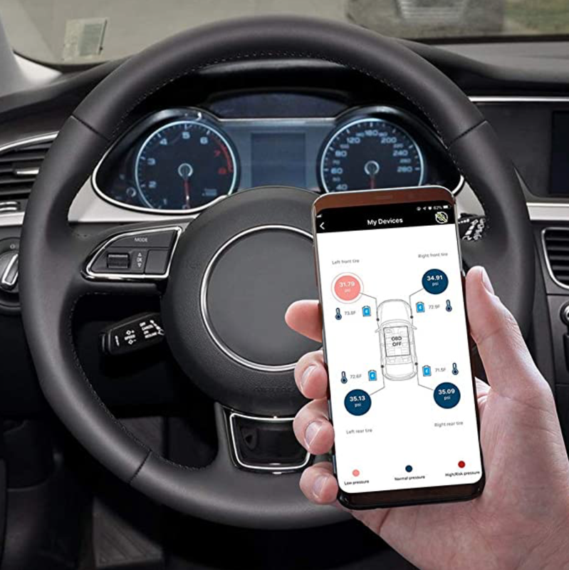

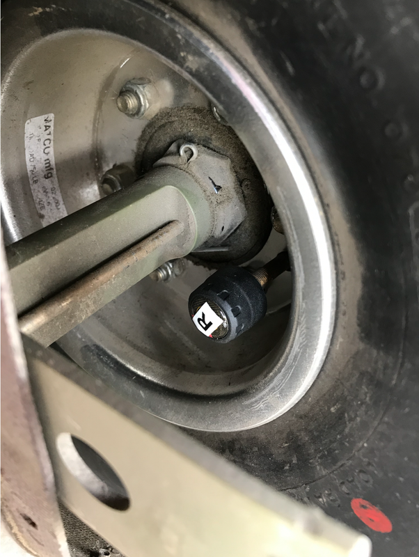

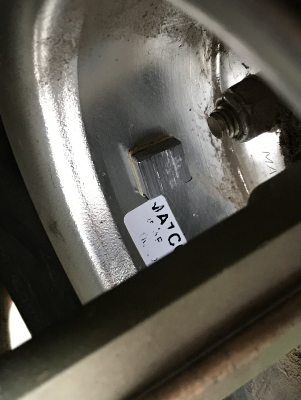

I bought Honeywell Tire Pressure Monitor System (TPMS) for $55 and mounted sensors on the RV-12 main wheels. There is not enough clearance on the front fork to allow using a TPMS for the front wheel. Four (4) sensors come in the package normally used on an automobile. Tire pressure and valve stem temperature are displayed on your cell phone. The sensors are designed with replaceable batteries which normally last two years. I have the other two sensors mounting on my motorcycle. For both the airplane and the motorcycle I added one square of balance weight opposite the valve stem. Individual sensor weighs 9 grams and one square of balance lead weighs 7 grams. Works a charm?
