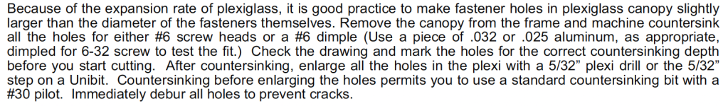

I'm helping a local shop that is replacing a tip-up canopy on an RV-7
It was installed by drilling clearance holes for the AN507-632 screws along the sides of the skirt, but the holes were not enlarged to provide any room for differing thermal expansion. The canopy cracked, and upon removal, there are cracks starting at every screw hole. Clearly the oversize holes are important.
So - following the installation instructions for the RV-6 (because that's what I have) it describes drilling these holes thru the canopy and skirt, and then disassembling and drilling the canopy holes oversize (either 5/32" or 3/16").
But here is the odd thing: the canopy skirt aluminum strip gets dimpled for the flat head AN507-632 screws. But the instructions do not say to countersink the plastic to accept that dimple. The enlarged (3/16") clearance hole may be big enough to accept the dimple, but contact between the edge of the hole and the dimple would restrain the plastic, defeating the purpose of the oversize holes.
I'm wondering if there was a later update to my (very old) version of the RV-6 KAI that added the instruction to dimple the canopy plastic? Or is this a persistent oversight?
We intend to put some countersink into the plastic to receive the dimple with some 'wiggle room'.
thoughts?

I oversized the holes and over countersunk and then used SS tinnerman washers to spread to load over more of the plastic. This was on the front of a slider without dimpled aluminum strip. On the sides with aluminum strip I slightly over countersunk so that the screw head is bearing on the aluminum and the metal is bearing on the surrounding plastic not so much the dimples. I did some test countersinks in scrap to establish what felt right.
Ed
Yup, +1 except the washers.
Drilled the larger holes and was generous on the countrsinking - not overly so, but just enough. All holes were also generously deburred on the inside and all cuts in the canopy were smoothly rounded so there were no sharp edges.

I also countersank the transparency holes. I urge you to buy a diamond beveling chamfer bit to do the countersink. It won't leave an edge on the countersink, reducing the risk of a crack start point. Search for 'diamond countersink bit' on the 'Zon

I did this with 1/32" wall thickness soft silicone tubing. Obviously you have to drill the holes a bit oversize. Knock on wood, no cracks so far.
I do what Matt did - with soft surgical rubber or soft silicone tubing. The goal is to not let the screw or Tinnerman washer countersink “cone” touch the plexiglass, just the soft rubbery thing. I have yet to have a crack at a screw hole (yes…I have had cracks elsewhere - that step-down weld joint about a foot from the aft end of the RV-8 canopy frame is my nemesis….. no screws or rivets anywhere around it!))

To your original question.....yes the plexi needs to be countersunk to accept the aluminum side skirt.
I did the following:
  1. Drill undersized pilot holes through the side skin / plexi / canopy frame sandwich.
  2. Use a piloted countersink bit to machine the countersink the plexi to fit the #6 screw dimples on the side skirts. Hint: make a sample gauge to use for a dimple to plexi fit check. I think I used a #30 piloted bit (too long ago to remember exact size). The bit was a standard 3 flute type......might have splurged for a new one.
  3. Open the plexi holes for the appropriate clearance holes.....whatever van's recommends on the plans.
  4. Open the aluminum holes to the standard #6 clearance.
