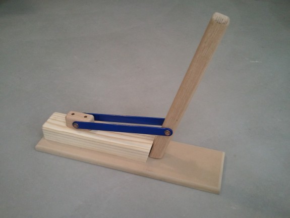

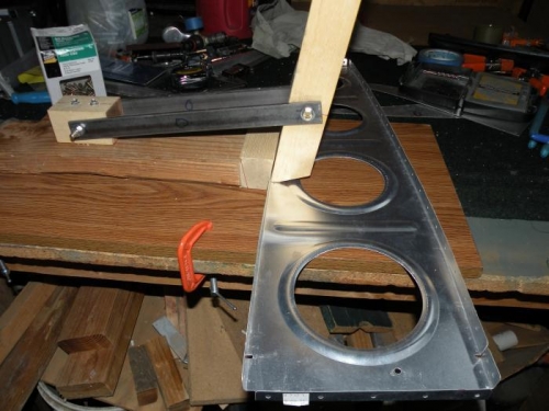

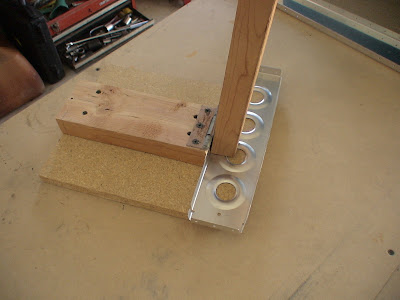

Here is my version of a tool made by Bill Gast of Boone Iowa (Gotta give credit to the man who invented it) This REALLY makes the tiresome task of streightining rib flanges go fast, accurate and easy. Mine is made of some old Oak I had on hand, some flat bar from the local ACE hdwar store, a few screws and 2 AN Bolts from the used box . The angle between the anvil and the sqeezer is 11 degrees on the face and 11 degrees on the bottom of the sqeezer.
