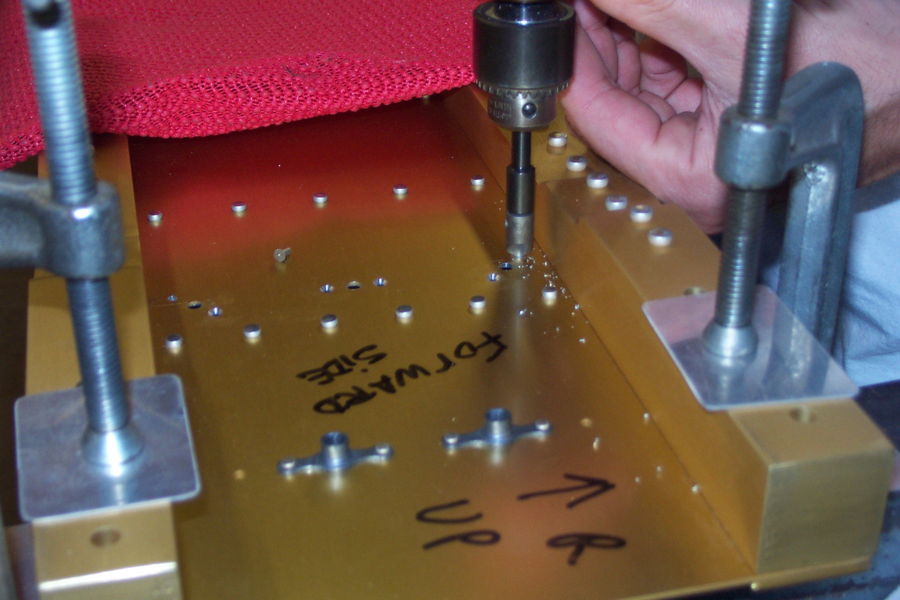

In the image, I need to countersink the 3/32 hole in the top center. This is the wing spar and the countersink is for the fuel tank attach nutplates. It's a tight spot because of the height of the step bar behind the hole. Even my modified cage (visible in the image) doesn't fit. See page 13-4 of the RV10 plans. I started to do it by twisting the csk cutter with my hand but decided I'd ask how others managed this one before doing something dumb.

Remove the bit from your auto countersink tool. Install it in your 90deg air drill (same thread). Countersink your part.

I placed mine in the speed deburring tool and did it very carefully...No need to cut the microstop in half.

I used my deburring tool with extension and piloted bit. Also as above my "snake kit". You'll need to use this method in several other places.
Hex adapter
There is a thing called (IIRC) a "hex adapter" which has the thread for a countersink cutter or a threaded drill bit at one end and the other end fits into anything that takes a hex bit. Alternatively, the hex end can be chucked up in a cordless drill, which is what I do when countersinking in "suicide mode" as is required here. The cordless drill will give you terrific control of your speed.

Tap the roll pin out of the collar on the back end of the countersink that you have shown. Carefully disassemble the tool and use the shaft only out of the countersink in your drill. Feed slow and keep checking the depth.
I used the countersink bit removed from the microstop with the threaded drill bit mount from my angle drill kit:

If it is just for a nut-plate, you can also just trim a little material away by hand and use the so-called Oops rivet. Took me a while, but I eventually embraced this little beauty....... ;)

Master craftsman Dave Howe in California uses the so called oops rivet in nutplates. The rivet spec is NAS1097-3-2.5 It has a 3/32" shank and a tiny head, these should only be used in pure shear applications. They take less of a countersink, and we make dimple dies that fit them as well.
Also for the discerning builder, and also commissioned by Mr. Howe we make a set of screw dies for the same thing. Shear only applications the NAS8702U2 allows for a screw that looks smaller than a #6 and has the shank of a #8. As most are aware the larger the dimple the larger diameter of stretching occurs around the hole that is being dimpled. For inspection panels this screw will minimize this stretching an give a super smooth look.

As explained, it's a 3/32 with a small head - a mini version of the one we use when we have to drill out a hole oversize. Not that I've ever had to do that :eek:
The beauty of it is that you can avoid dimples and hence having to dimple the nutplate. Becuase of the small head, a couple of turns with a deburring tool by hand makes a big enough c/s and it can be used on skins down to about 20 thou.
