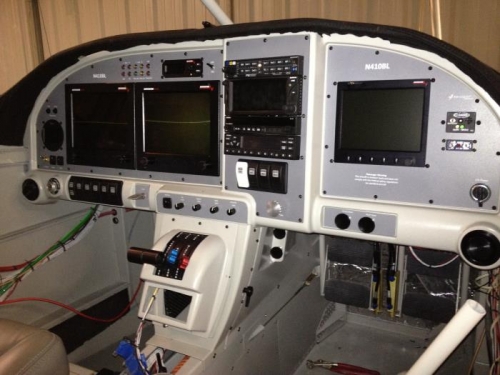

Aerosport Products lower center console works great with the throttle quadrant from Vans.
Like Mark mentioned, you need longer cables than come in the FwF kit. Cablecraft makes a higher temperature rated sleeve than want Vans sells, so I took the opportunity to upgrade to that at the same time.
Modification of the control lock is pretty easy too. Basically replace the existing bolt with an AN3-60a, if I remember the size correctly. That allows you to position the lock handle outside the lower console.

Here's a third option with the Aerosport Products panel. With Geoff's panels, there are two different throttle quadrant options depending on the type of panel you choose. The following is Rob Hickman's (AFS) personal RV-10.
Notice that with this Symetrical panel the quadrant is mounted a little differently and also give you a little more space for additional avionics. If I were doing my panel again, it would look very similiar to Rob's.

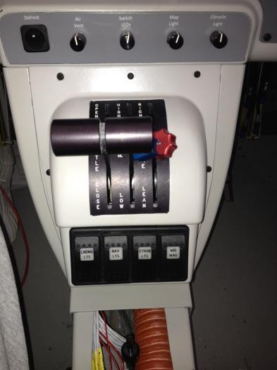

There's an option that is easy to install as well. Install a center console, like this one from Aerosport Products.
I find I can rest my elbow and arm on the arm rest allowing me to easily adjust the throttle quadrant. I can rest my little finger on the panel insert to give a little more support if needed. I suspect the same is true with a vernier.​

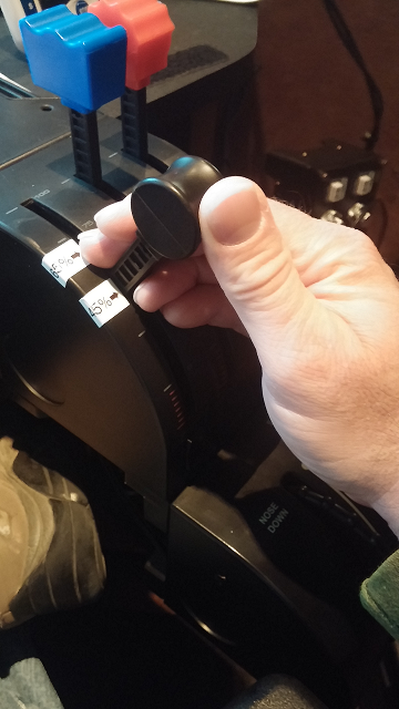

I don't fly an RV (yet!) but in my Warrior, I place my fingers on the throttle in such a way that I use only my finger muscles to adjust the throttle and mixture. I'm able to get very precise control this way. I have thought about vernier controls a lot--are they that much more precise? I have a digital tach in the warrior and can quickly adjust the revs within about 5 rpm on the tach using my method with the quadrant. Very fine control takes a tiny bit more time but very small inputs can be made by anchoring the ring and pinky fingers against the quadrant and working the middle and index fingers against the thumb.
I'm sure others do it this way too, but here's a pic of my technique (demonstrated with my sim quadrant as I'm not in the plane right now).
