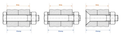

Grip length is the distance between the bottom of the screw's head and the bottom of the nut. It's the length of the fastener put into tension by torqueing it (...well actually the tension tapers off up into the first few threads inside the nut (I forget exactly how many maybe 2-3 carry most of the load, depending on grades, etc.). That is the whole reason why torque values are set....to get a specific tension set in the fastener....
I understand that y'all all are talking about "grip length" as using the shank as a bearing surface to resist the shear. So that the entire length within the joined parts is not threaded.
Unless the hole is a tight friction fit against the fastener, I contend that the joint has outright failed if that ever happens. I mean, have the parts have moved away from their intended locations at that point?
and the thing is, in order to get a properly tensioned screw (in the world of industrial machinery, structures, etc... anyway) you usually want a lot more than just one or so threads that would be covered by a washer or two to be in the grip length.
I've gotten the idea that at least in a general sense, AN fasteners are sized so that the stress riser from only one or a partial minor thread diameter in the "clamp" does not pose high enough stresses in the screw for the design working tensions...basically the screws are grossly oversized for tensile strength
...or maybe, this idea of no threads in the grip only applies to some aerospace applications where the screws can be oversized or are otherwise not in high shock or high thermal loading applications
I went online and dug up some generic images.... saw several that did refer to the shank length to be the grip length as you're saying ...but that is contrary to anything I remember ever seeing before.....from my perspective that seems like a more generic fastener property term, and has nothing to do with an actual joint design. I found one interesting image from a fastener company in the UK that differentiated between grip and clamp lengths. I also don't recall using those terms.

I think this paragraph is key to the article in Kitplanes and to my question, and probably should have been stressed...because the premise is not true for all threaded applications. I'm sure even in aircraft. There are bound to be applications in the structure and most certainly in the engine and other areas that are not primarily shear loading....
it really just echo's the point that catpart made earlier
Shear Heads and Nuts
In the aerospace industry the general ground rule is to design
such that fasteners are primarily in shear rather than tension.
As a result, many boltheads and nuts are made about one-half
as thick as normal to save weight. These bolts and nuts are
referred to as shear bolts and shear nuts, and care must be
used in never specifying them for tension applications. The
torque table values must also be reduced to one-half for these
bolts and nuts.​
