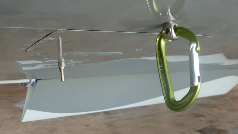

I just found these pictures on the camera ? had been meaning to post them for a month or so. Our two-place airplanes have standard RV tie-down rings, and they work just fine ? but Tsam just seemed to want something special! These ?rings? come from Cleveland Tools, and we find that it is easy just to leave them in all the time ? I am sure someone can compute the drag and subsequent airspeed loss, but they sure seem to be pretty small.
Because we are space limited on Tsam, we carry some high-tech Spectra line for tie-downs, and while we could get by with S-hooks to put through the tie-downs, we are carabiner people?so we spent some time at REI trying every ?biner they had until we found something that fit.
These all work about as well as regular rings and ropes?.but they somehow fit the ?alien? look of Tsam better!

If I use my own tie down ropes which or 3/8 in they work great. At most GA airports the tie downs are 1/2 inch and with a little weathering and dampness, they have become too big to go through the larger holes, so a carabiner or other type hook must be used.

Too bad. Those small-radius edges really knock the strength of Spectra or Dyneema line way down. For 1/4" line you're looking at perhaps 25% of the rope strength remaining over those. Small line will have less loss due to the relative size of the radius of the edge compared to the radius of the rope.
Also, if the Spectra line has no outer cover, it's pretty slippery. I've found that knots slip at about 25% of the rope strength in single-braid Dyneema, which is similar to Spectra. It's fascinating to watch the bitter end of the line slither through the knot, while the form and tightness of the knot holds until the end.
Of course those tests were at a slow rate of load (or in this case, strain) application. I don't know how they'll behave in a rapid load, except to break at the sharp edge.

I bought these, and spent an hour at REI, and could not find a 'biner that fit, except for a small aluminum one.
I am worried that the little aluminum carabiners, which are made for clipping gear to your harness, not for clipping yourself to a rope, are not strong enough for tie-downs.
So, for now, these pretty tie-downs are sitting in my tool box.
Also, the holes in the tiedown "ring" remove so much metal that the tiedown itself is not as strong as I think it should be. The web site says they yield at 1500 lbs. That's probably good enough.
If I could find some small stainless steel carabiners that fit, I guess I would try them again.

Yes, that is a very good solution, I use shackles like that on the halyards on my sailboat. But it is a bit fussy to have to put those on first, then tie the rope through it. 'Biners are so quick - just wish they made one small enough that was strong enough.
They do make shackles with a spring-loaded 1/4-turn latching pin, but they also are not strong enough.
