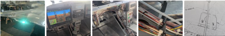

Build Update ….RV-12 Bob Collins
The middle block on the rudder/brake assembly went back in easier than I expected (and certainly easier than it came out) thanks to the powered nut driver. One good thing about taking everything apart is it made it easier to reorganize everything, specifically the three "holders" in the top bracket. So the one on the right now holds the brake lines and heater cable. The one on the left holds just the heater cable, and the one in the middle doesn't hold much of anything. I also zip tied and bundled all wires as I had to remove the nice SteinAir lacing.
One conundrum is the route of the pitot line. I think the plans were changed somewhere along the line because the depiction of the lower bracket (which I had to drill out and is now reinstalled) is different throughout the KAI and with the version of the lower bracket I have (three snap bushings), there's no place for the pitot line and I'm concerned about it chafing on the edge of the lower bracket. The instructions say to zip tie it to the zip tie holders but there aren't any. I'm thinking of loosely zip tying it to the brake lines and putting a big blob of RTV there.
I reconnected all the connectors and fired up the avionics and everything is fine.
I still have to reinstall the fuel tank. After that, I'll start over with the PAP and then try the engine start again. We don't think this fuel leak had anything to do with the lack of power and the very troubling stall of the engine when the second fuel pump was brought online. I looked at the pump wiring to be sure the wires were consistent throughout and they were (and both pumps had developed acceptable fuel pressure during the first go-through of the PAP). So we'll have to see what that's all about.
I do have some concern about stress on the brake lines as the rudder pedals move but I guess I'll just monitor that situation.
This completes all the work in the tunnel, which remains a really crappy design feature of the 12iS. I wouldn't wish this maintenance on anybody.

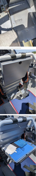

RV-8/8A Storage Ideas …RV7 To Go
I made a storage compartment on the RS between the gear tower and the spar for my "stuff".

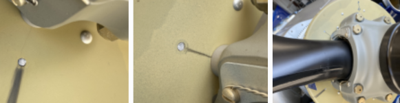

RE: Spinner backplate rivets
I have two missing rivet heads at 320 tach hours. No special vibration, most cruise at 2450-2500 RPM M1B Factory Lyc with standard mags and Cr. This is the Hartzell composite with a 2.5" spacer for the James Cowl, and Vans spinner. Balanced 200 hrs ago, w/weights added to the flywheel. 22 ft-lb torque confirmed on through bolts. Note the streamer from one rivet and to the other. No crack yet found after cleaning with naphtha. That could change if cracks are found.
Should the rivet size be increased? They had to be drilled in the center with #40 bit to punch them out, but is it bad form to just replace?
Odd, why just one blade? and the one with factory balance weights attached.
I will contact Hartzell to gather their comment. If no cracks, the rivets will be replaced and checked in the future as usual.
Any thoughts/comments invited. Thanks
