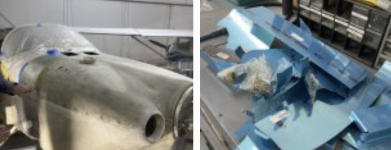

RE: new cowling fit
…Marlonyoung RV-4
Yes, made several cuts until it shrunk down to a nice fit and shape, with the hinge fully secured to the fire wall side. When I got it fitting right, then Cleko the hinge it into place on the cowling and removed the cowling and riveted the hinge half to the cowling. I then put the cowling back on and with a resin, floss or balloons filled in the gaps, sanded down. Then I ran a 2 inch tape over top, back edge side to side to reinforce and capture/ cover the rivets and “cuts” and the feathered it forward to smooth shape. Did all that while attached to firewall (packing tape on firewall side to keep it clean and resin out of the hinge) to match the shape.

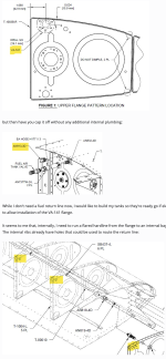

RV-14A fuel tank internal fuel return plumbing?
I'm starting work on my RV-14A fuel tanks. The plans call for installing a VA-141 finger strainer flange that could be used for a fuel return line: but then have you cap it off without any additional internal plumbing: While I don't need a fuel return line now, I would like to build my...
