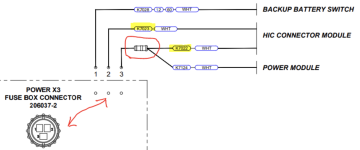

Tony Kirk RE on HIC module RV12is
Yes, the EMS bypasses the HIC Module. You can start and run your engine using the EMS switch as long as you turn the EMS switch OFF after engine start.
The LED color on the IGNITION Module Arduino is irrelevant. It can be red or green based on the Arduino manufacturer. These LEDs are Not used for diagnostics.
If the Diagnostic LED on the HIC module is White then the HIC is getting the 5 volt start signal (SBB) from the IGNITION Module, proving the SBB wire is pinned properly and the IGNITION Module Arduino is commanding the HIC MOSFETS to connect both battery busses together. It sound like both of these modules are working as they should.
The next thing to check would be the X3 connector at the Rotax fusebox, to be sure the wires were inserted in the proper position. This is a builder-populated connector, and it wouldn't be the first time it was assembled wrong.
The schematic has all the circuit numbers. Also check that the circled solder-sleeve appears to be properly melted.
HIC module RV12is
Have a no start problem. Tech at Lockwood says HIC module is the problem. Anyone have had a similar problem and fixed it by replacing module. Sam
