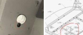

Drilling Engine Mount Ooops
This one kinda hurts. I’m not quite sure what I was thinking. I read and thought I understood what I was doing when I drilled the engine mount to the firewall but I obviously miscalculated. I know what I did wrong and would obviously do it very differently next time.
That being said, here I am. As you can see from the picture, the lower two engine mount bolts didn’t completely take out the pre-drilled hole in the firewall WD-803-L&R weldments. I emailed Vans and their response was that due to the location and nature of the 4130 steel that it is fine to leave it as is. The 4130 steel isn’t as susceptible to developing cracks. They recommended to put a larger washer on the backside of the firewall I assume to spread out the clamping force of the bolt.

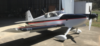

Finished RV-6 Pic …egp8111
This one kinda hurts. I’m not quite sure what I was thinking. I read and thought I understood what I was doing when I drilled the engine mount to the firewall but I obviously miscalculated. I know what I did wrong and would obviously do it very differently next time. That being said, here I am...
Show us a picture of your FINISHED RV-6/6A!
Finished August 28, 2022. 180 hp, carbon fiber GA prop.
