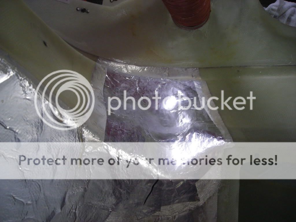

My #2 exhaust spring is just touching the heat shield. Did others have this issue too? I've tried to move the muffler a little to the left and right but no luck also the if I move to far right the #3 spring hits the water line. Actually both the #3 & #4 springs come very close to the return water lines.

This has been on the form in the last 2 months. Most first time builders have in stalled the cowl tunnel to high and have found out later that the clearance on that spring and the Exhaust header were to tight and had to modify the cowl after the fact because the engine moves around more in flight than on the ground. So if yo dont have at least 1/2 " space between your exhaust header and the heat shield then you will get something like this after your first flight.
How much space on that spring? Not exactly sure but I would say at least 3/8". How does your space between you header and the cowl look? If its to close then get your dremal out and cut a hole in your tunnel and put new fiber glass matte in the cut out slightly bowed away from your spring and header. Then reapply new heat shield that you had left over from the first time. It will look like this.

Ron I would say that that header is going to hit the cowl in flight. But if you want just leave it and see what happens on the first flight. Even if it doesn't hit on the ground during the run up remember the engine moves around a lot more in flight.

Now put the tunnel in and at the back make sure you are lined up with the radiator and then lower the front part of the tunnel so that you have a least 1/2" clearence between the tunnel and the header. Maybe tape a small 1/2" peice of wood to the bottom of the header and just move the tunnel up in place till it hits the wood. If the tunnel is resting on or maybe 1/8" high above the edge of the upper part of the oval cut out in the lower cowl then you will be very close.
My mistake was attaching the tunnel to high. I believe in the directions it shows the rear part of the upper tunnel flange attaching just under the piano hinge line on the lower cowl ( I dont have my directions in front of me at the moment) which is why I mounted mine high. There are a lot of variables here like do you have the lower cowl line up and do you have the exhaust center correctly, etc. It is important to make sure that the tunnel lines up correctly with the radiator and the opening in the tunnel to the radiator is trimmed out as much as possible to allow max air through it, but not to much that it effects the gluing on of the seal between the radiator and the tunnel. You must do the same with the Oil cooler opening, trim it so you have it big enough not to cover any fins. One more hint if you have not made the bracket for the oil cooler yet trim the aluminum edge of the bracket that goes in the front of the oil cooler to max so as not to cover any fins there either. A lot of people are having the oil temps run in the yellow in the summer heat so you want as much air as possible going through the oil cooler and radiator. I live in Texas and its 100F here now so we are heat sensitive. Ok Im ready for Scott to shoot arrows at me now.

I fit my cooling shroud exactly as outlined, trimming the butt joint for the oval inlet only to the scribe line and fitting it with no overlap. My cowling was all fit with the engine and spinner in place and the scribe lines were nearly spot-on. However, I also encountered minimal (1/8") clearance between the spring and the cooling shroud and as expected, it began to rub with engine movement during the first engine run. I had to basically do similar fiberglass work to what John described earlier in the thread, cutting out an elongated area and then building it back up with a trough. I made mine smaller, as my header seems to have adequate clearance. Just hope I won't have to revise it later.
I think that there is just enough variability in all of these close fitting parts that even installed properly, some will have less than adequate clearance. While the alteration was not difficult, would be nice if a slight change was made in the cooling duct fiberglass mold for future builders such that there was a bit more clearance in this area. It does not appear as though a 1/4 inch drop in the area would have any negative impact on airflow to the radiator.

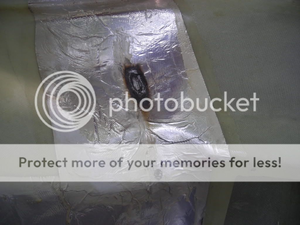

Picture ... deja vu
That picture is identical to the burn through my cowl. When cowl removed imagine my surprise. It didn't touch before the flights.
The fix! opened the hole up more for clearance with the exhaust. Painted the edges of the opening with epoxy (about an inch and a half).
Laid two layers of fiberglass cloth in the hole and pushed it out until a perfect depression molded around the exhaust.
Painted the cloth with epoxy and flox.
After two days layered the depression with two layers of heat resistant.
I see no change in engine temp as a result of the repair.
