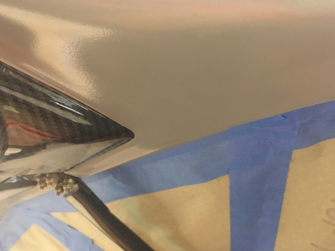

You can use regular catalyzed urethane auto paint, applied with a low setting on the air on the gun. That gives you big drops of paint. Don’t thin the paint and you’ll end up with a textured finish
Kyle that sounds like an effect I have been trying to duplicate, do you have any photos of that to share?
It isn't something that photographs easily, but you can see the texture in part of this one. Contrast it with the slick finish on the carbon fiber. FYI, the grey paint has some flattener added.
