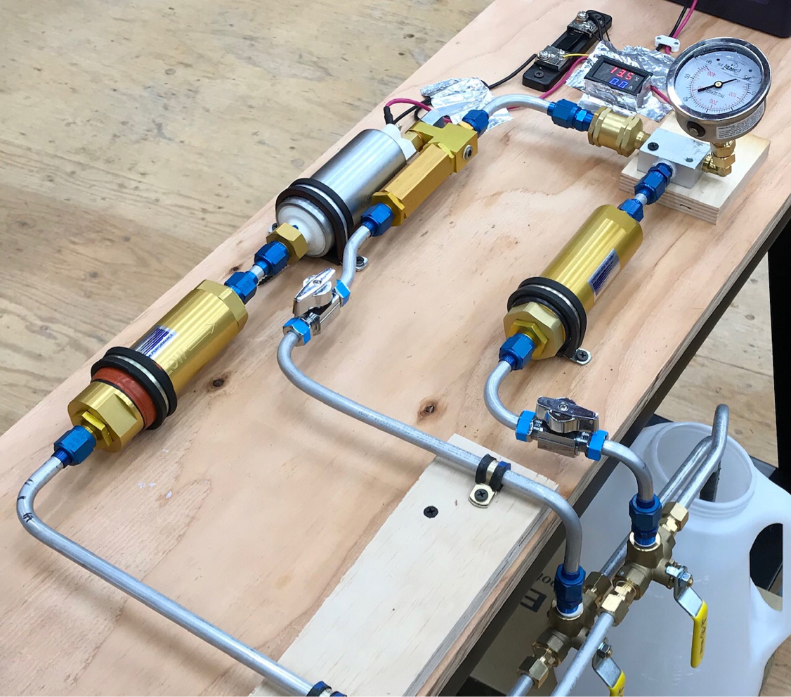

Here is the setup I built for bench-testing output and electrical consumption of electric fuel pumps operating at various pressure levels. In order to make it as real-world as possible, it purposely includes enough filters, fittings, bends curves and total lift to roughly simulate the friction losses that will be encountered in the actual installation. None of the hardware-store components you see are for installation in an aircraft, and my own final installation will include dual pumps , dual external relief and check valves, and dual electrical sources for each pump.

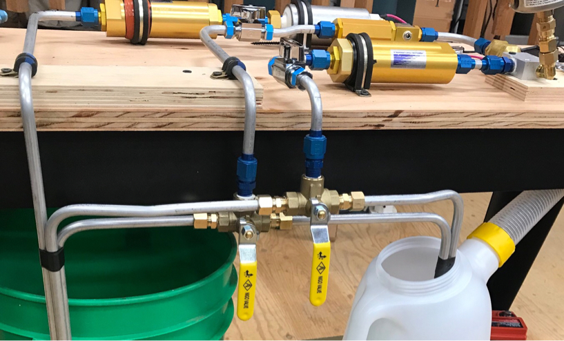

The three tubes seen lower-center include the pickup tube and return lines from the relief valve and from the “net output restrictor” will rest inside a 5-gallon pail of stoddard solvent. Both of these have 3-way brass valves so their flow can be individually and fully diverted to a separate graduated flask for measuring flow rates with a stopwatch. At the top you can see the battery, switch, shunt, V/A meter, and pressure gauge. The two in-line ball valves will allow closing or restricting flow through the relief valve or to the “engine”

Operating the pump with the output line closed and the relief valve line open and shunted to the measuring flask will allow measurement of relief valve set-point pressure, electrical load, and maximum flow available at that pressure. Operating it with the relief valve return line closed off, and the main output line shunted to the measuring flask, the inline valve can be used to dial in any pressure desired and measurement of current, pressure, and flow rate at that pressure simultaneously.
The Delphi pump supplied by Airflow Performance is shown installed here and will be the first tested. You can see the Walbro GSL414 banjo- mounted to another relief valve package in the lower left. Testing it and the Walbro GSL395 will require a few mods to this rig as their banjo mounts have to be inserted from the opposite side of the relief valve assembly.
