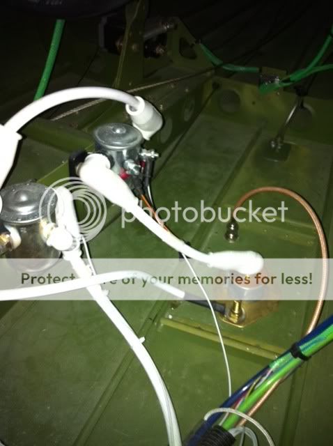

To jump on the battery bandwagon a bit, here is one for a bit further down the construction path.
I used the pigtail leads that came with my "battery Minder" to attach to each battery, and then ran them forward through the baggage bulkhead so I could keep the batteries up.
I drilled a 3/4" hole for each lead, used a rubber bushing I split with a knife, and a tab of velcro and made a label for the plug.
Here it is with both lead locations showing, when I finished the fabrication.
And finally as it goes into the plane.
When it comes to working on the panel and lighting, it is nice to be able to top off the battery as you are working. I spent many hours programing the EFIS and the EIS. and just learning the systems, and I never had to worry about running the battery down.

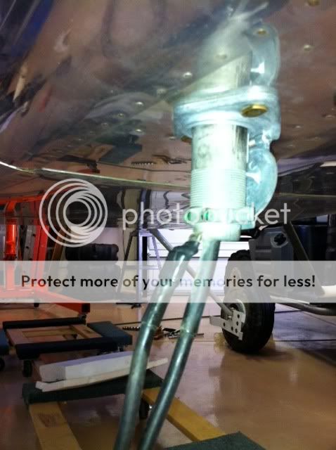

It has been very nice to power up the plane during wiring to test stuff. (excuse the fibreglass dust on the floor, I haven't final cleaned yet)
The flat 3 pronger is, by far, the most common on ramps around the country. Unfortunately the male plug is heavy, sometimes way heavy, and the cables are usually beefy/heavy too. So, if you install one make sure you brainscheme up a really solid mount inside so some ramprat doesn't oil can your skin.
