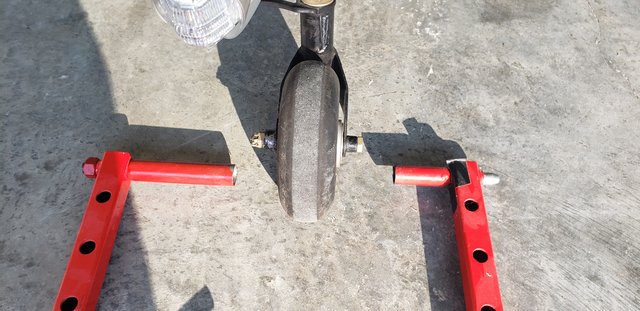

Are you using some kind of extended bolt on your tailwheel?
Every “put the little wheel between the rods” type tow bar i tried proved to be close to useless as the tail wheel always popped out.
I did a simple modification of the nose gear tow bar by making one side have a longer and larger diameter - one that would slide over the axle nut (the left one in the below photo). In addition, two bushings were added along with a longer axle bolt to make sure the tow bar did not pop off the axle.
This has proven to be very secure, no matter how I’m pulling on the plane.

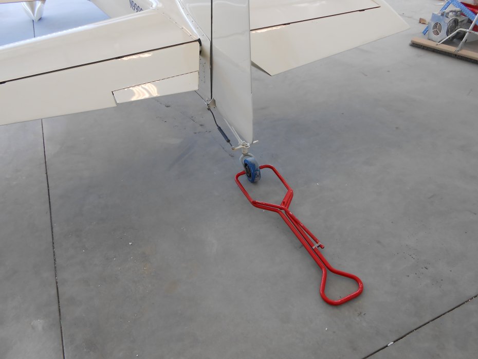

I bought a used Cessna towbar off of eBay for cheap.
Added a hose clamp to keep it closed. Formed aluminum tube, fits in RV-6 cargo area. Super lightweight.
