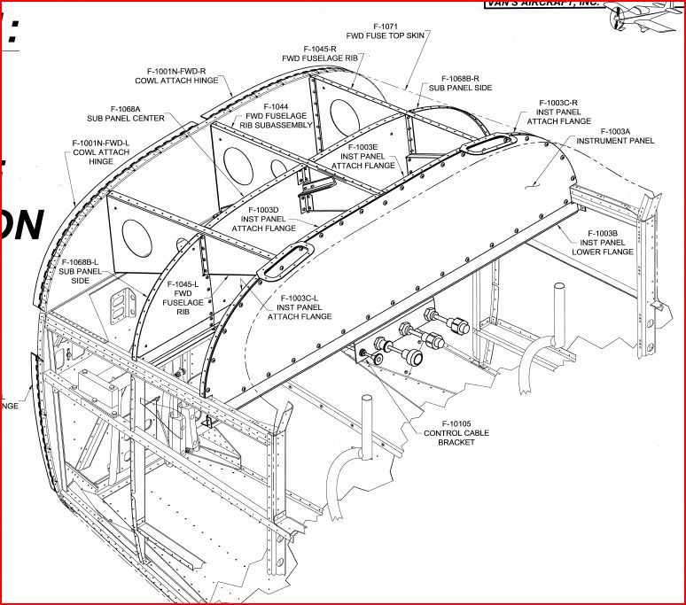

Builders, I need some help getting over this major mental block that I seem to have regarding mounting the various misc subpanel black boxes like: manifold pressure sensor, fuse blocks, lightspeed module (future), and engine monitoring box, etc.
Because the entire subpanel structure is riveted in place and will basically never ever get replaced easily due to being riveted in and the windshield right above, I am having a hard timing just drilling mount holes in fwd fuse ribs and such to mount black boxes directly. I keep wanting to come up with a better method for future access, as well as changes. Maybe use a platform sistered to a rib with standoffs? Maybe use standoffs instead of just mounting direct to rib?

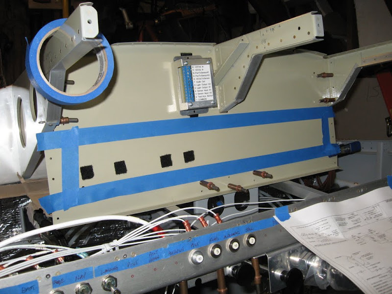

My main panel is in 3 pieces, and the two on the sides are arranged to lay flat for service. This allows access to the sub panel items also.
I had posted photos on the sticky about panels, but the photo hosting site is TU.
I will get more shots up here in a while.
To do what I did, you have to have all the wiring go towards the bottom edge of the panel, and have enough slack to pull the panel section out a couple inches, then lay it down.

I have all of my grounding tabs, terminal and fuse blocks, and avionics contactors on the firewall. A bit of a reach to get to, but it is an open area and keeps the higher voltage wires away from avionics and antenna coax cables. On the forward side of the subpanel is the invertor/dimmer control board, llightspeed Plasma III control box and the avionics cooling fan. Should have put the manifold pressure box there too, but I had a case of rectal cranial inversion (Head up A@$) and put it on the aft side (so I had to run the tubs through the panel after splicing into the ignition box) with the GRT EFIS RAIM GPS box, XM weather receiver, ADI Back up battery box, and the other things that are more likely to be accessed over time. Everything I anticipate needing access to is available by removing an EFIS screen, or reaching up on the firewall. The items on the forward side of the firewall are a little more challenging to get to, but still not that much more difficult.

Boy, i still can't decide: cut big subpanel access holes like William or no, like most others.
Looks like Ivan also cut large access holes, for many of the same reasons. Continues for the next few pictures.
http://albums.phanfare.com/5187035/2292606_4807168#imageID=83785792
Frequently, i catch myself overdoing things. i just can't decide if this is another one of those occasions or not. Almost ready to flip a coin.
I started marking out where to cut the radio stack. Then i figured instead of cutting out "just enough" for the radio stack, why not cut out plenty to the left or right. It would give:
1. Plenty of room for the avionics stack, including a future Garmin 430 upgrade.
2. In the future, if i decide to move the avionics stack further out to the right of center, the subpanel cutout is already done.
3. Give access to the firewall.
4. Gives plenty of room to route wires thru the subpanel.
The major downside is the loss of mounting real estate.
Just a thought ----
One thing for you to consider is that the rear of the radio tray should be fastened to the sub panel, not just cantilevered off the instrument panel.
I am dealing with that at this time, and the task is a bit more difficult due to the over sized hole in the sub panel.
