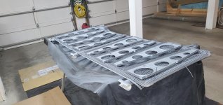

3. Spray in sets (all left set, all right set, etc...) keep the parts separated till primer is dry. Then remark part # with sharpie.

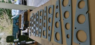

I placed the parts for spraying in the logical way they went together.
Left rib is on the left, right rib on the right, yada yada....
I use Ekoprime as well (love it). It does indeed cover Sharpie marks more than every other primer I've tried though. I originally bought a box of a billion cheap paper tags thinking I'd tag the parts since the Sharpie gets covered up. What a waste of time. It's completely unnecessary. I think I've used two tags. For parts that actually need a mark to keep straight, like ribs, after etching and cleaning I usually just mark them with a number that I also mark on the plans themselves (so ribs are Left 1,2,3,4... and I write on the plans to show if I started "1" on inboard/outboard). I spray in order and lay them down in order on a piece of cardboard that I mark with the number. Then when parts are dry enough, just transfer the mark back to the part. No reason to complicate things.
