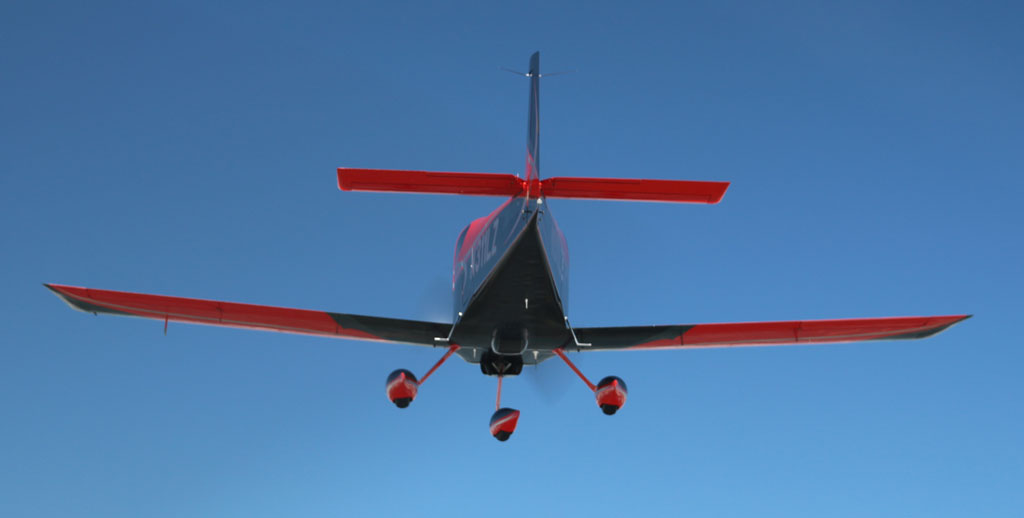

I had the same problem at around 70 hours. The belleville washers loosen up after a while.
Here's a picture of what it looked like on my plane:
It did, but it must have not been a huge yaw because I didn't notice it much, my buddies saw it when we flew in formation. The breakout force was down to 13lbs.
