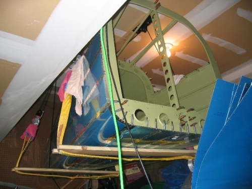

Had the same problem with my RV-12 fuselage :)

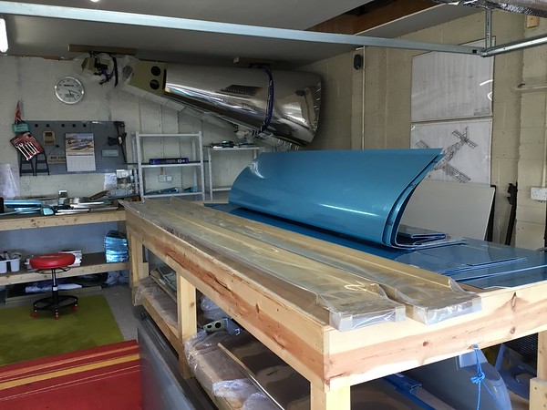

Mounted on the ceiling of my garage/workshop
Was light enough for my wife and I to hoist easily. Some eye bolts and ratchet straps did the job.

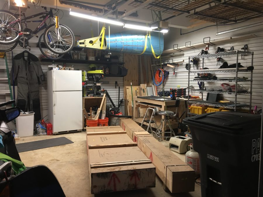

I went with a garage gator and we park our cars under it (12ft ceiling)- garagegator.com
It raises and lowers with a button press. we'll use it for other non-aviation related hobbies when the plane moves out of the garage.
If I were to do it all over again... I would do exactly the same thing :)
