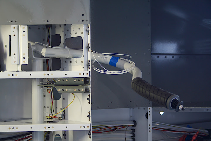

Just curious about stick grips. I know bicycle grips work well, but how is the PTT button secured? If anyone has a good source for grips, i would like to know. pictures are helpful too. Thanks

Hit up Aviation Depot or Lowes Aero and in the hardware section drawers you should find the metal end caps. Select the proper size for your stick then mount a simple push button in the center of the cap. Mount it in the top of the stick prior to pulling the grip over top (put a hole in the top for the button first).
I looked at what was available in terms of true aviation grips and one issue is that the size of the sticks in the RV-12 are apparently a bit smaller than many other sticks. I had trouble finding true aviation grips in the right size.
Good bicycle grips work well and you do not have to do anything special for the end caps. Just find a set that has snap-in, plastic caps on them. Any good bicycle shop will have them. You can then drill the plastic cap for the PTT switches and they are simply secured with a nut and washer.
I used these Serfas grips and have been very happy with them so far:
http://bgindy.com/product/serfas-connectors-grips-62153-1.htm
As an aside- there is a very simple method to install them nicely outlined in a prior issue of the RVator- involves using compressed air blown in from the bottom to create an air cushion between the grip and the stick. They slide right on without the need for soapy water or any other messy method.

I bought mine a a local bicycle shop and followed the recommendations to fitt the PTTs. The compressed air trick REALLY works
