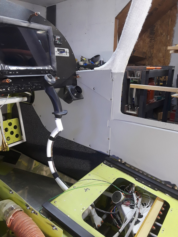

So mine are wired with the wire routed through the straight portion of the stick and taped along the outside of the curved portion of the stick. One of days I'll cover the curved part of the stick with a "boot" to pretty it up. I used a CPC round connector to terminate each stick for easy removal. The CPCs are anchored to the gear weldments directly under the seat pans.

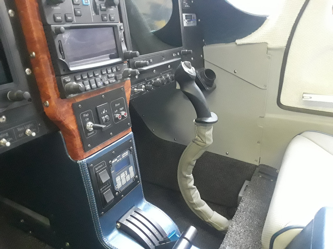

I also have a Tosten grip. I ran the wires through the top vertical tube and taped them down the rear of the curved tube. I purchased a nice grey leather steering wheel wrap and sewed a zipper on it to make a nice cover.
I used the mini-Molex connectors from Digikey mentioned earlier in the thread so I could pull the Tosten grip through the tube without needing to disconnect any wires.
And the cover pic

I ran the wires out the bottom and taped to the stick similar to several posts here. I used a DB9 connector under the seat fastened to the gear leg brace. However, I would not use a DB9 again because I've had to remove the stick grip once and it doesn't feed through the tubing without removing the DB9 pins from the connector.
