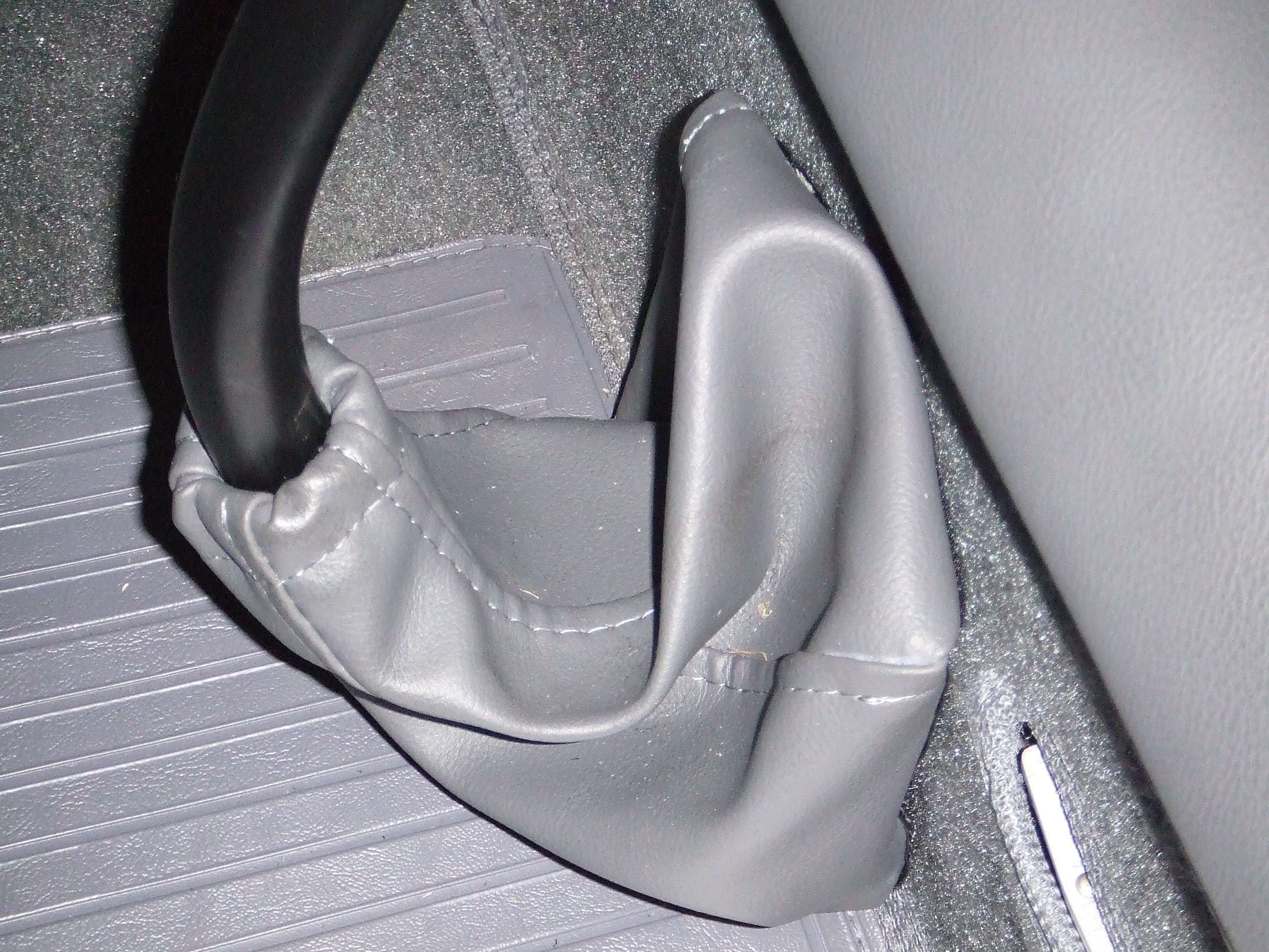

Installed the Flightline stick boots yesterday. Less than 5 minutes and a perfect fit! Now no worries about dropping something into those gaping holes while bouncing around in turbulence.

Planned to install the stick boots today after a breakfast flight to LZU. Very nice looking, but find they are a tight fit when movings stick full travel. ie; moving the sticks from side to side tend to bunch up the fabric somewhat restricting travel.This occurs a little on aileron control movement but is a bit worse on full pitch moves. Reason appears to be the mounting plate has too little clearance at floor. The good news is normally such extreme moves are rare. Was considering shaving a bit off the bottom of the mounting pad to eliminate the pitch clearance issue. Anyone else notice this feature, and if so what did you do to remedy, or am I over thinking this? (I tend to be intolerant of anything that impedes free stick action). Thanks.

FWIW. I discussed with Abby at Flightline and she said they will reduce The outside dimensions of the mounting plate to eliminate the restriction. I don't know for certain yet, but I believe that will take care of the issue.

I have never flown the 12 without the stick boots but I haven't found them restrictive at all in flight.
They're certainly less restrictive than dropping a pen through the hole and into the works.... :eek:
A bit of a close up shot:

Stick boots installed...

Received my stick boots about a week ago and installed them with no issues. I don't find the interference that Dick mentions, so Flightline Interiors must have taken care of that issue.
I like em! Finishes off the interior nicely and as mentioned before will prevent anything going into the holes.
