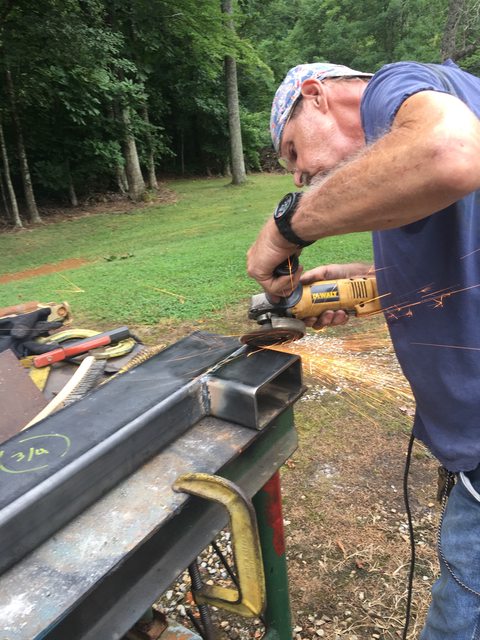

I had used an horizontal band saw at work to cut the parts to length. It is absolutely necessary for some of the ends of the tubing to be perfectly square and perpendicular. Therefore for those parts and faces, I used a vertical milling machine to true up the parts.
Then it was on to the welding table. We don?t have a MIG welder so we stick welded them with low hydrogen rods. We TIG welded the top front ram mount faceplate to the top tube.
![jvEllCsl.jpg](/proxy.php?image=https%3A%2F%2Fi.imgur.com%2FjvEllCsl.jpg&hash=a476316fdd7101211761841f95f2ea9c)
![viKJkq8l.jpg](/proxy.php?image=https%3A%2F%2Fi.imgur.com%2FviKJkq8l.jpg&hash=a2f7f1a1d81978720a98fb85fd20c515)

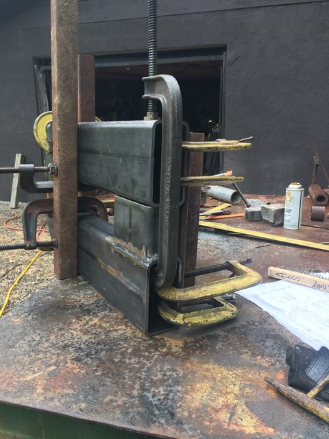

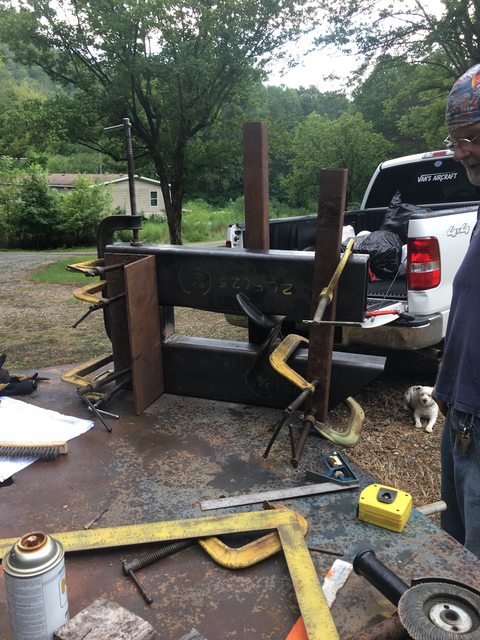

It is absolutely critical that the frame be straight, square, perpendicular, and strong in all the right places. Anyone that welds will know that welding can pull your parts in all kinds of directions so it is necessary to clamp, clamp, clamp! Also you have to be mindful of the welds, heat, etc.
Clamps!
![pJdum7Gl.jpg](/proxy.php?image=https%3A%2F%2Fi.imgur.com%2FpJdum7Gl.jpg&hash=909091ecba10941735ec915a3c1fb730)
More clamps!

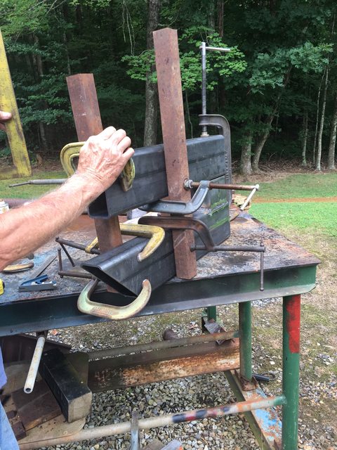

![cskR5gVl.jpg](/proxy.php?image=https%3A%2F%2Fi.imgur.com%2FcskR5gVl.jpg&hash=3543749a2fbaa71def6850f4d69ca7c1)
Even more clamps!
![5UkLabRl.jpg](/proxy.php?image=https%3A%2F%2Fi.imgur.com%2F5UkLabRl.jpg&hash=ccffaaae47bebc6d1fcb06399cad2dcb)

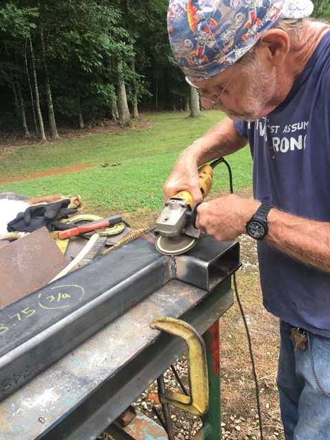

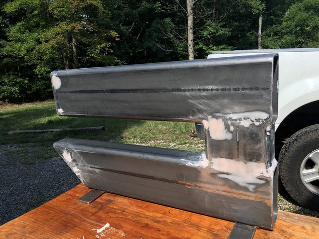

So once the welding was done, I wanted it to look good so I put some filler in the right places and sanded it all smooth.
![qVVOgeNl.jpg](/proxy.php?image=https%3A%2F%2Fi.imgur.com%2FqVVOgeNl.jpg&hash=11cc9acc29f272dc3929a70186a6deb8)

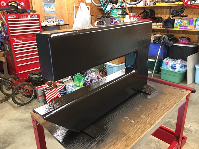

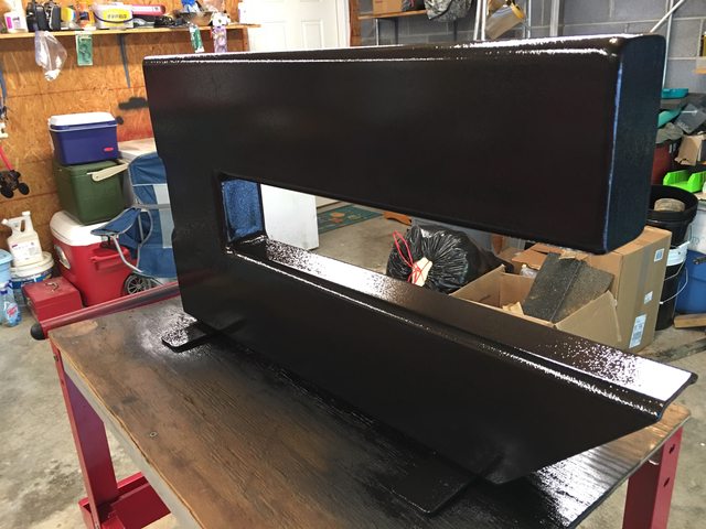

And finally, degreased and painted the frame with Rustoleum Hammered Black.
Looks great!
![8tq5kLrl.jpg](/proxy.php?image=https%3A%2F%2Fi.imgur.com%2F8tq5kLrl.jpg&hash=06330747df669ce8a68386c1cc6f4727)
![ygoCoZPl.jpg](/proxy.php?image=https%3A%2F%2Fi.imgur.com%2FygoCoZPl.jpg&hash=f0f04d86dd961121b5450c8bf602c549)

There is a ton of work that goes into building this frame correctly. If the top front end ram mount face is not perpendicularly to the bottom beam, the dimples will be negatively impacted and poor quality. Paying close attention to the build will eliminate the need to shim the ram and or lower die holder later to get it all to run true. The high cost of steel, welding gear and consumables, paint and labor makes it hard for me to imagine how Paul sells his completed units for the price he does! Do yourself a favor and just pay the man and buy his ready made unit!
On my original years ago I used 1/4? wall tube when the plans only call for 3/16? because that is what I had on hand. I decided to build this one out of 1/4? as well because I learned to love the extra beef in the original. I am sure the 3/16? would be fine however.
