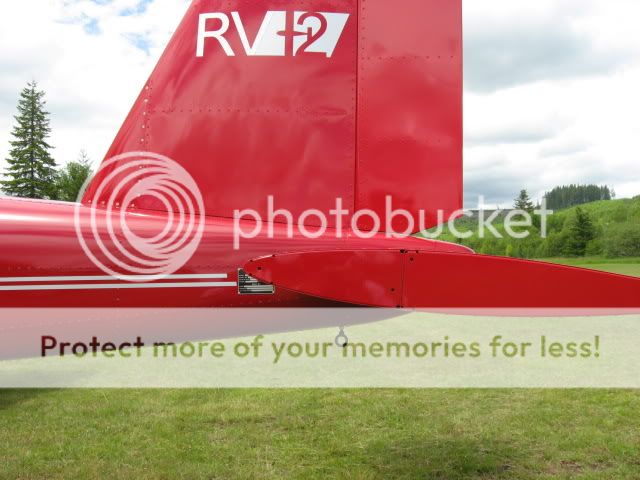

Protoype Stab
I wanted to be sure that mystab deflections were correct so I shot some photos of the prototype when I checked out in the airplane. These are "full down" positions.
Wayne 120241/143WM
Wayne I found your picture on an earlier posting and took it to the hanger yesterday... it helped. My stab's leading edge looks very close to this but its hard to say... I tried to sight the lead edge with the row of rivets in front of it.
