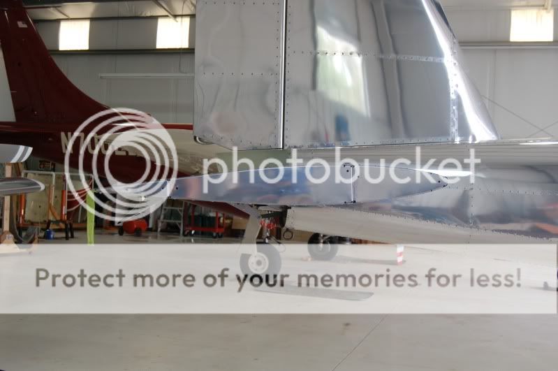

Here's a photo of my stabilator with full forward (pitch down) stick and full "up" trim (i.e. pressing "trim up, the bottom side of the rocked switch). Look right to you?

Your PAP from Van's will give you measurements to use to make sure your elevator is at the correct position up and down.
Wayne,
The stabilator has such little "down" travel, it's impossible to judge from a picture. Like Pete says, go by the plans, and you'll be fine. If you are asking about the direction, that looks right. The tab should go down for "up" trim.

I thought the tab direction was right-- I had to reverse the two white wires to get this direction. Sure would have helped if the emp kit instructions had told us which way the servo arm should travel. As is, there's exactly a 50-50 chance of connecting the wrong two white wires and ggetting the tab backwards,

That's why in the tail attachment section of the construction manual it doesn't tell you to complete the connections for the servo motor. It is delayed until later when the switch panel is installed, allowing for a check of the travel direction an then easy reversal if necessary.
