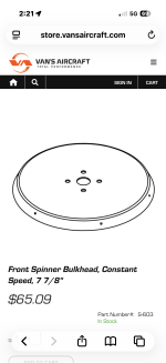

BTW can anyone confirm if a new spinner bulkhead is already pre-drilled? And if so, is it just the center four mounting holes, the perimeter holes to mount the spinner, or are the nut plates already installed? Part S-603 here.IMG_2884.jpeg
Buy a new spinner forward bulkhead and mount. Use the existing spinner as a drill jig to drill the spinner to forward buikhead holes. Disassemble and install nut plates for these holes.
Carl
By your reply, do you mean that the spinner forward bulkhead is not already pre-drilled for the nut plates? That would be great! From this picture in the Van’s store, they looked pre-drilled.
