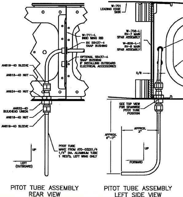

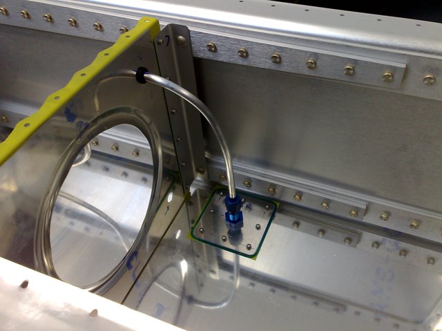

I choose the left wing since at least there is a Stall Warning inspection hole. I fitted my pitot forward the spar but aligned with this inspection hole, close to the spar and rib for support. I will fit a pitot similar to my RV7 plans, but you don?t drill through Spar flange, since it is forward of the spar, so you need to create a small backing re-enforcement plate. Then I drilled an extra set of holes similar to the routing wing lights holes in the ribs at the back of the ribs, close to the spar, leading inboard for the pitot line. At the most inboard rib I am thinking to put a 90 degree bulk head fitting pointing forward. I will connect a flexible pitot line (to aid wing removal) from this point somehow into the fuselage. I have not got a fuselage kit yet, so I don?t have everything figured out yet, but at least my wing is sorted and I am on the way to a VP prop. If you decide to do the same, use what I did as a guideline and apply your mind! You're the builder...good luck!
For reference below are my RV7 plans and some pictures:
A pitot mount re-enforcement plate just forward and clear of the Spar and ribs, but still close enough for support. Note the Stall Warning inspection hole for access to the pitot mounting point if ever needed.

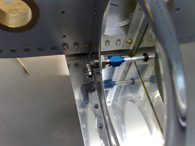

The fitting sticking out the bottom of the wing.
