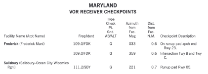

The chart supplement shows a VOR test checkpoint on the ground at KSBY.
Might need a bit more info.
Looked in CS_NE_20240516 and NE_3 both from the FAA website - can't find any mention of a VOT... (they don't use the acronym).
The CS_NE says it is there in the runup area for RWY5 and gives the freq but I can find the indicator in the diagram...
VOR receiver test facilities and checkpoints are listed in section 4 of the chart supplement - here's a screenshot:
Thanks - I was initially confused till I did some more reading...
No VOT here - it is a VOR Checkpoint for the real SBY VOR.
