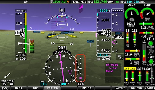

Hi all,
Sometimes I see this 'glidescope' to the right of my compass rose. Does anyone know what calculation is being used to drive it? I have only the stock D-1000T w/o any additional radios (eg., traditional VOR/LOC receiver). I'd like to use the feature, but don't feel it's useful unless I know what it's actually telling me.

I don't see Glideslope Indicator on that flight to HQM. You are high but still 60 miles out so maybe you are too high to intercept the 1.4° glide slope per your set-up? When will it appear? That is the question the OP is asking I think. His word is "sometimes".
Here is a flight, straight and level, not on an approach and above the glide slope, intercept is not possible continuing at this altitude but Glideslope Indicator is displayed.

Here is a situation where the Glideslope Indicator is not shown and then two minutes later it is shown.
Two minutes goes by and
It looks like if the indicator bar is off-scale then the Glideslope Indicator does not appear. That does make sense.
Looks like when you started descending at -200 ft per minute, next to the elevation tape, the glide slope showed up next to the rosette. Also, the needle is smack dab now centered in the magenta colored bug, which coincides with having an airport as a Direct To Destination. The cyan colored bug looks like its set for level flight in the first jpeg.
The first jpeg shows you flying level, no gain or loss in elevation, so you weren't really on a "slope" up or down.

According to Dynon the VNAV glideslope becomes active on the screen when you are 5 minutes from capture. You still have to arm the VNAV function, it's not automatic.
It will appear if your destination is an airport listed in the database. The autopilot will only follow it if you arm the VNAV to follow the glideslope prior to reaching it. You cannot arm the VNAV until the glideslope appears.
