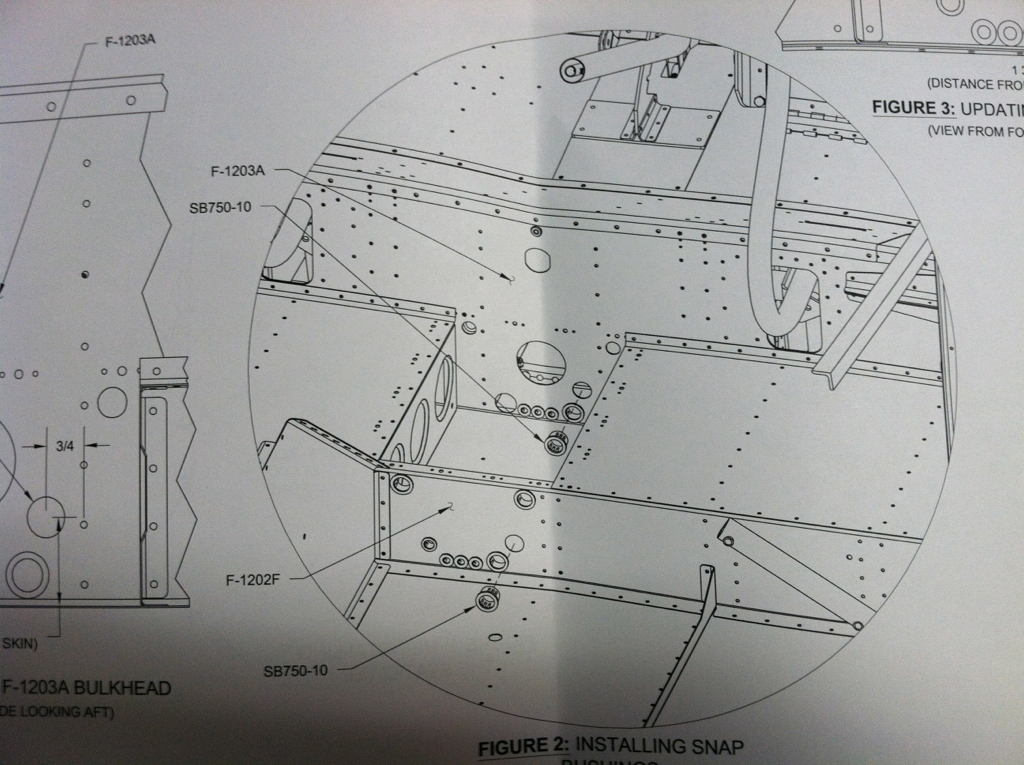

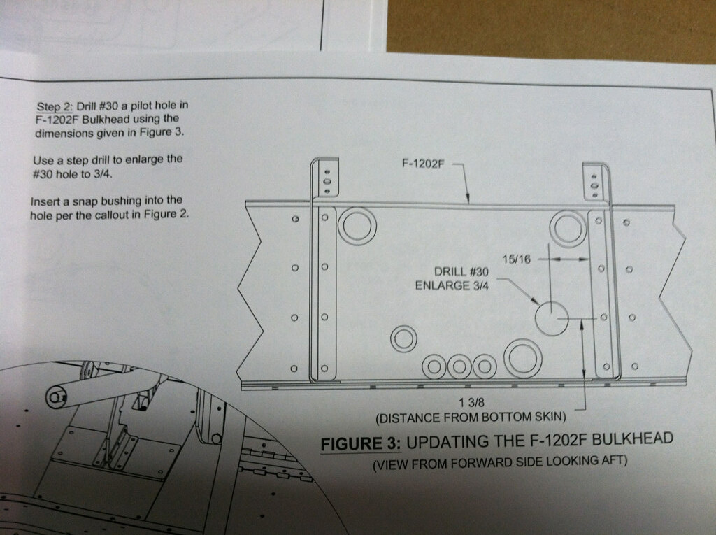

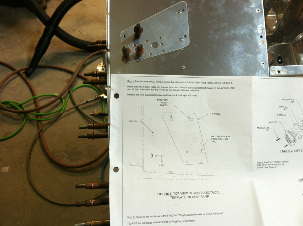

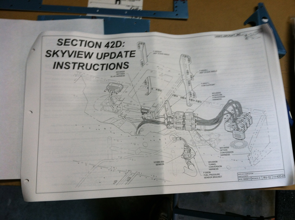

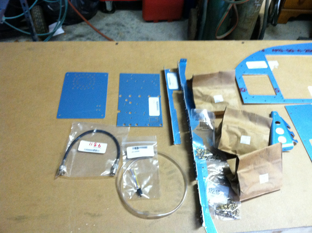

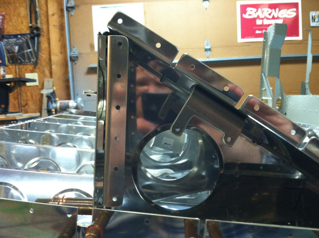

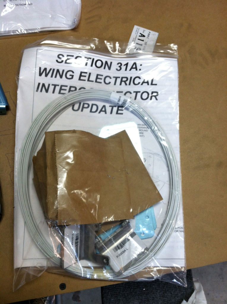

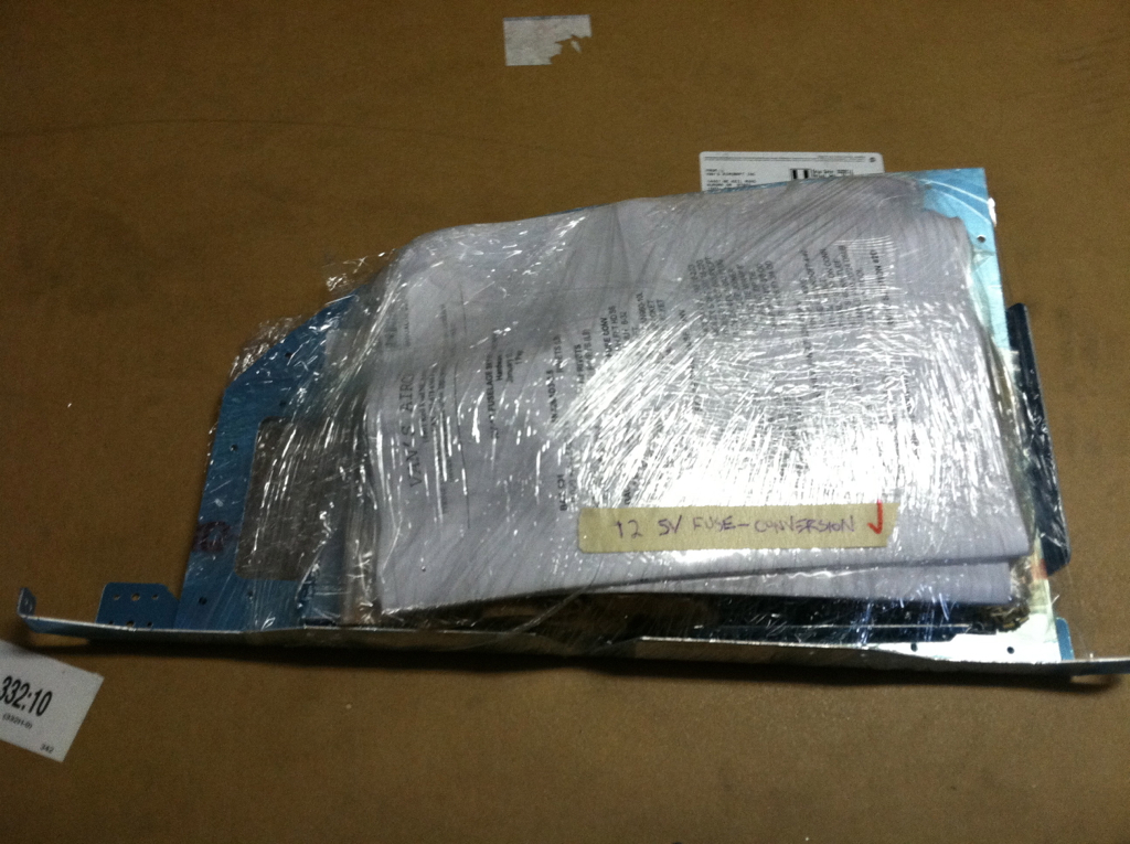

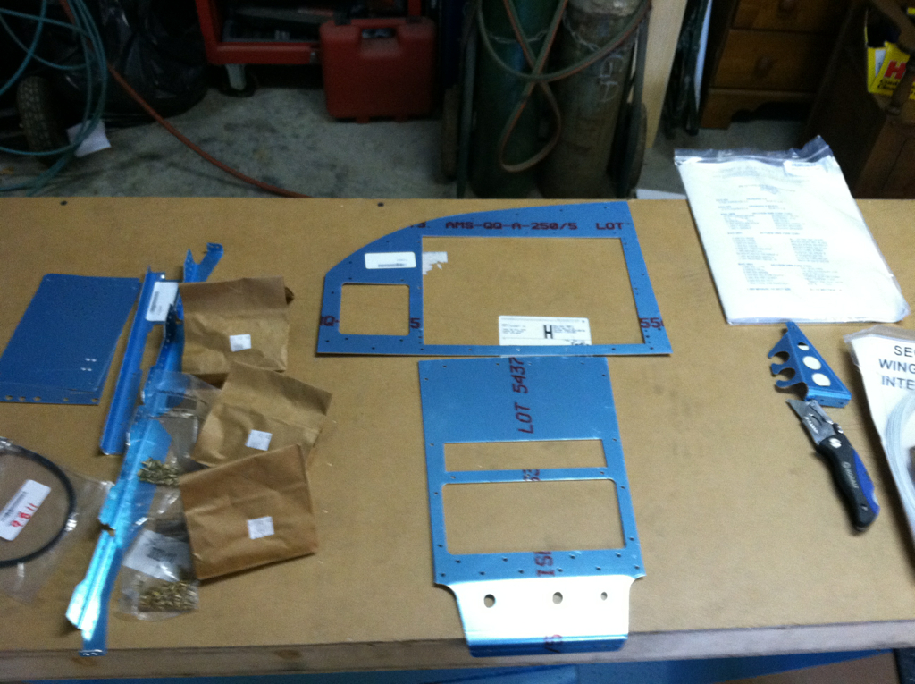

The parts to convert to Skyview came with my Finish Kit yesterday. Includes a wing wiring conversion kit as well.

So this is a "conversion kit"? Assuming you had it wired for the the other avionics kit and this allows you to change. Is the cost the same as it is for people that are wiring for it from the beginning? This makes it look like what people would have to do who had the already installed the original system. Another $13,000? Wow.

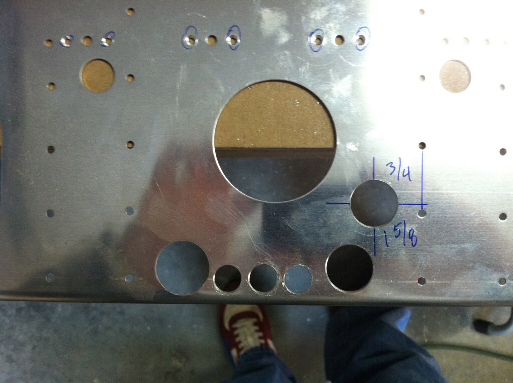

New panel sections included?
It looks like the new sheet metal for the panel is included (?) I wish I could get ahold of this now instead of having to wait for my whole panel kit to get shipped. I can't install the throttle cables until I get the new center panel.

It looks like the conversion kit gets a different pilot panel than kits originally shipped with a skyview panel. Specifically, the glove box, right side panel, intercom and elt remote are not removed for the conversion. Kits originally shipped with skyview will have the elt and intercom on the pilot panel with a redesigned glove box door. I am not an authority on the auto pilot, but I have read that the older servos will work with skyview with the appropriate update, but that is a question for Van's or Dynon to answer. I will be back in the shop tonight and will post some more pics as I run through the "conversion".

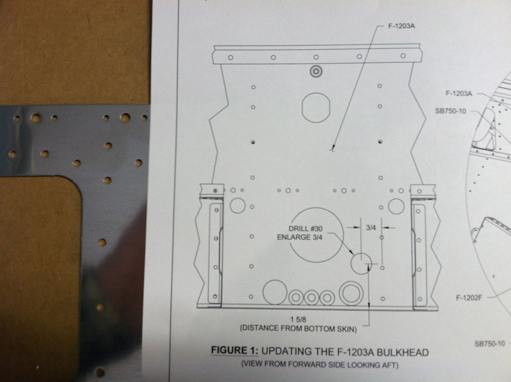

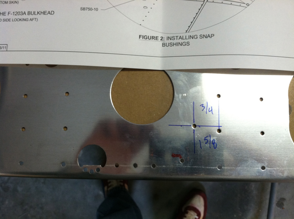

Connector update F-1226-L/R Drill Template

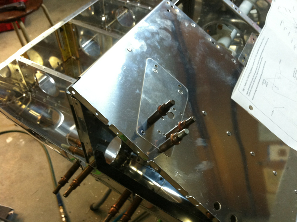

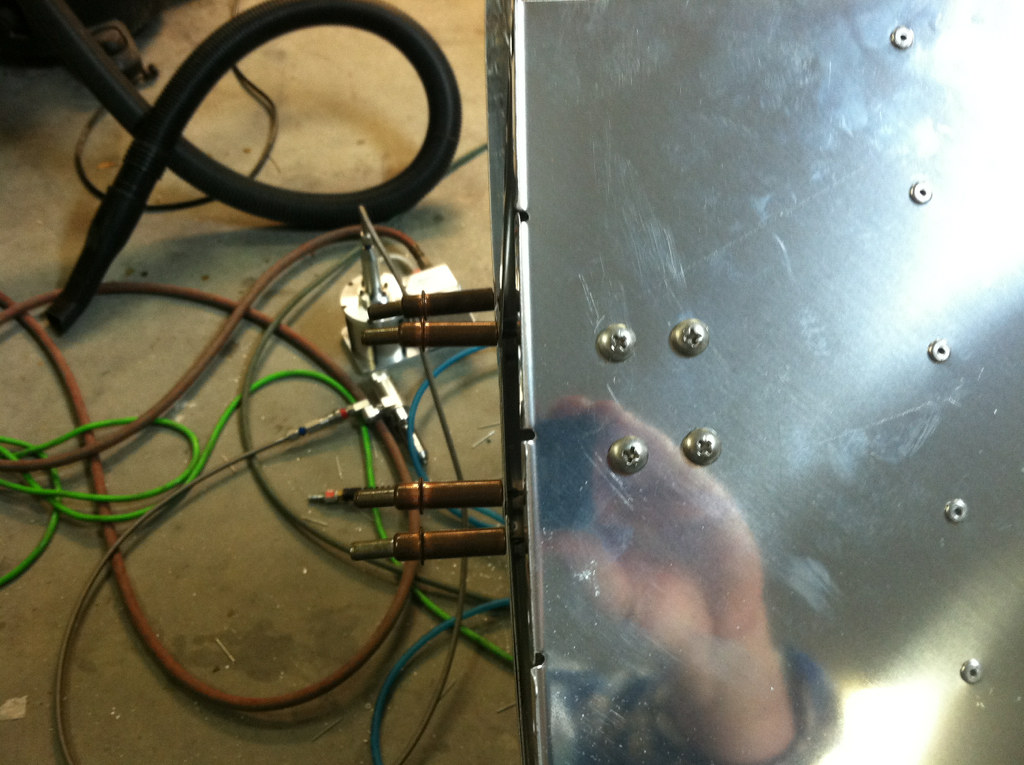

Fuselage side drill template and mounting bracket for new wing connector.

I hope Vans publishes the PDF of this update section on their website soon too.
