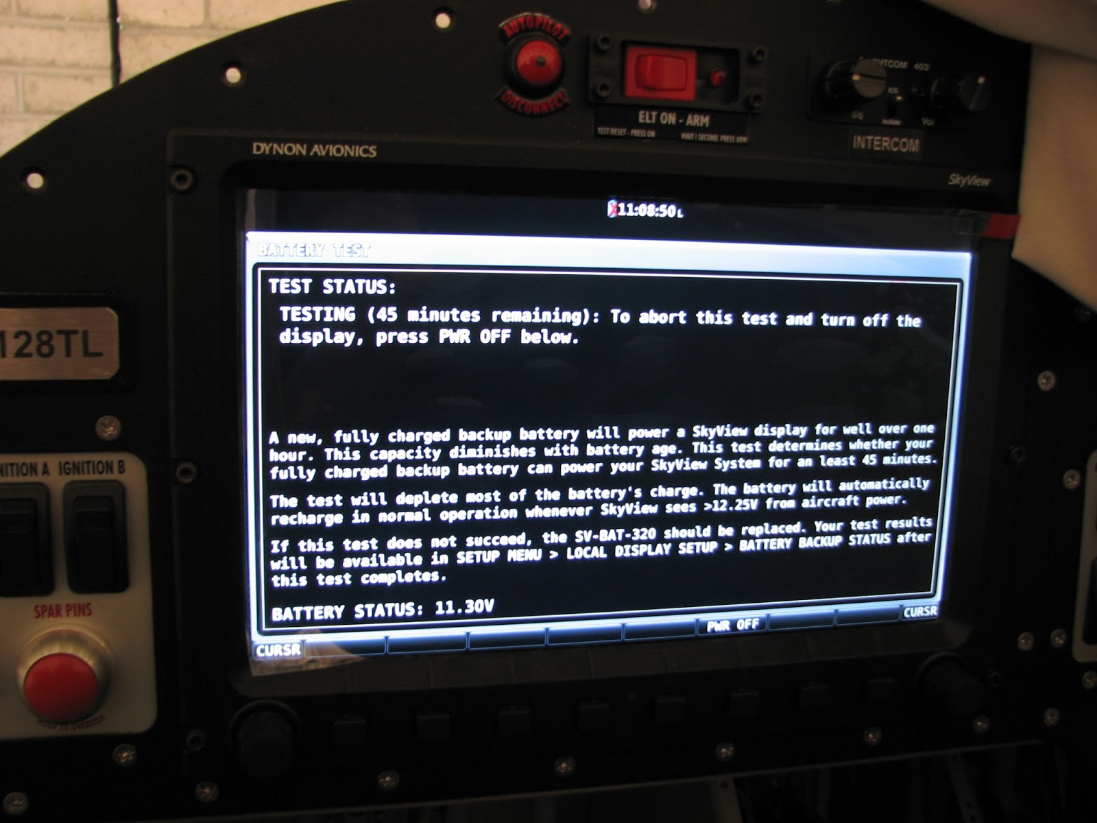

You probably just ran down the battery without the SV being in Battery Test mode. It will not recognize the accomplishment of exceeding 60 minutes of running on battery unless you make it aware of the fact that you are doing the test.
The way to do it is to charge the backup battery fully, then switch of the Main power switch. SV will respond by noticing the loss of main power and showing the SV will shut down in 30 seconds. On that screen there is an option to the far right that says "BATTERY TEST" or similar. Press the button underneath that option and SV will perform the test that will get recorded. The screen looks like this:

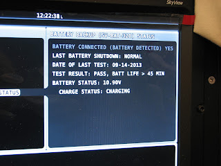

After the test has completed you will see it on the battery status page.

to charge the SV backup battery in a standard RV-12 configuration, you hook up a 12V battery charger to the main battery and turn on the Main switch. Let the system run until the SV is no longer charging the battery. You can watch the progress on the battery status page in the SV setup as seen in the small picture I had posted. You can also see on that screen if SV has detected the battery at all. If has not detected the battery or is not charging it, get it out and send it to Dynon for testing. I had problems with mine not lasting long enough and they replaced it right away.
