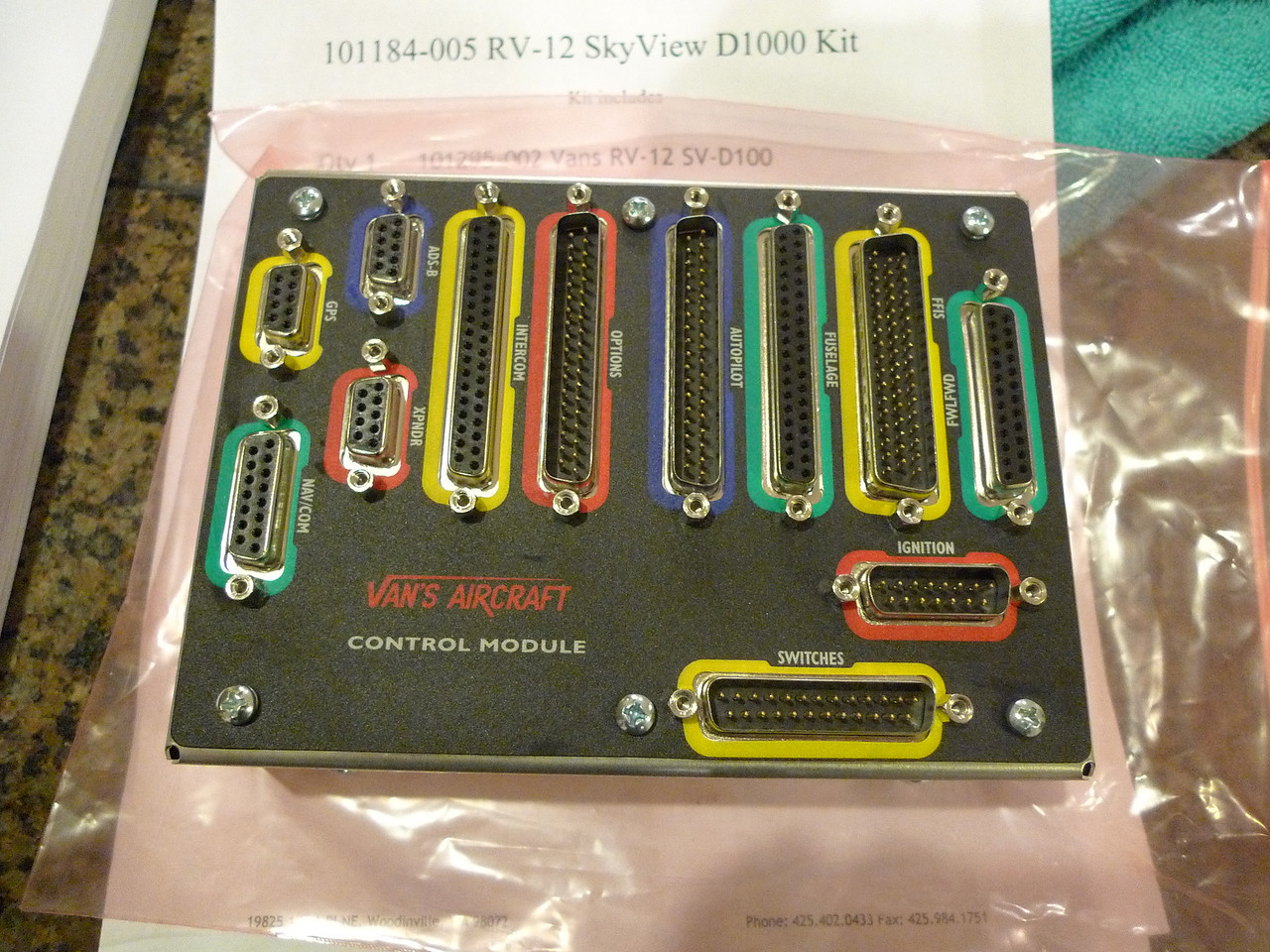

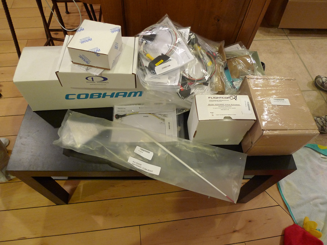

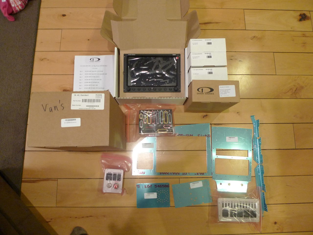

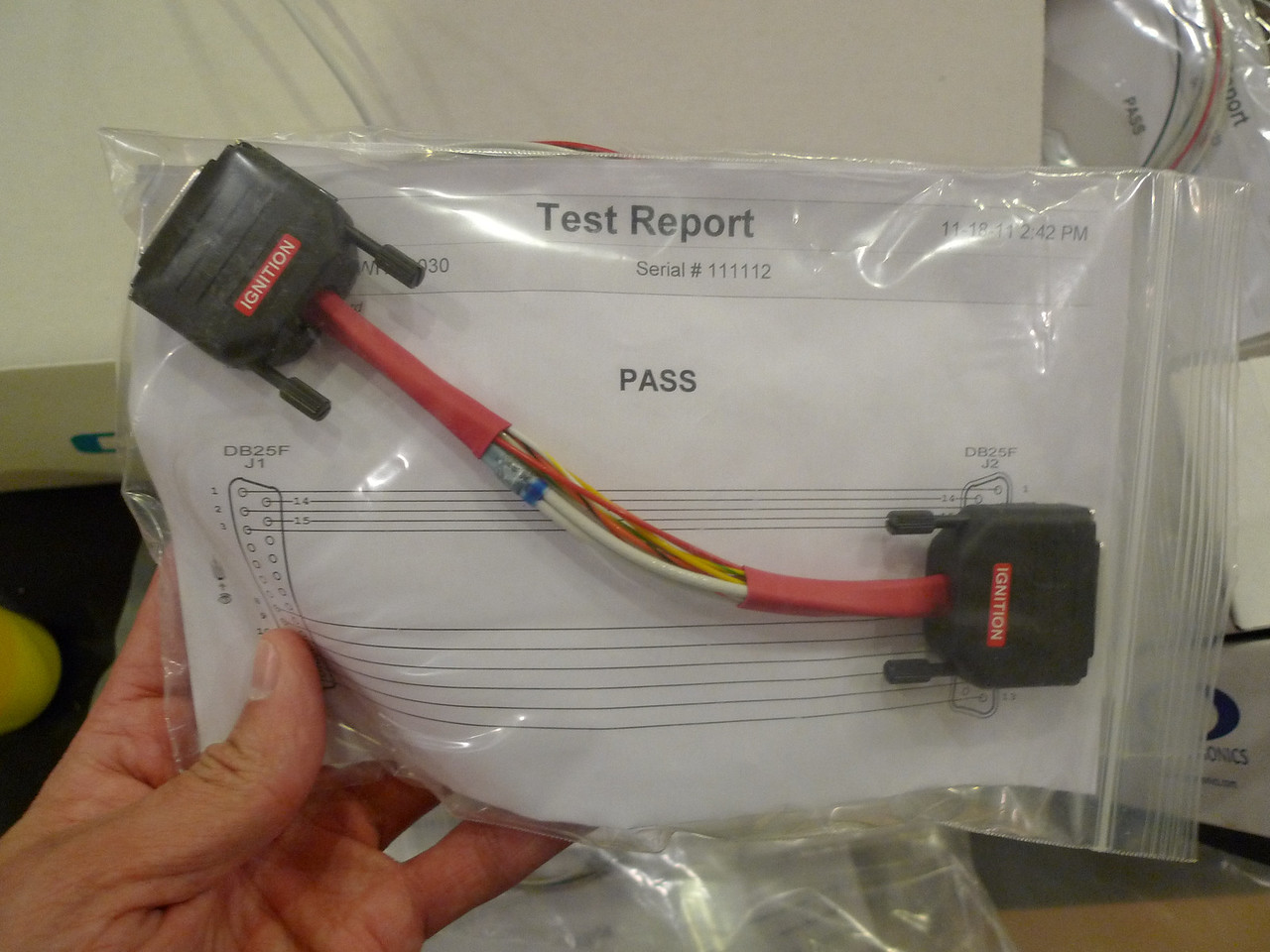

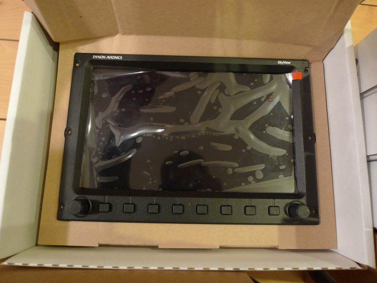

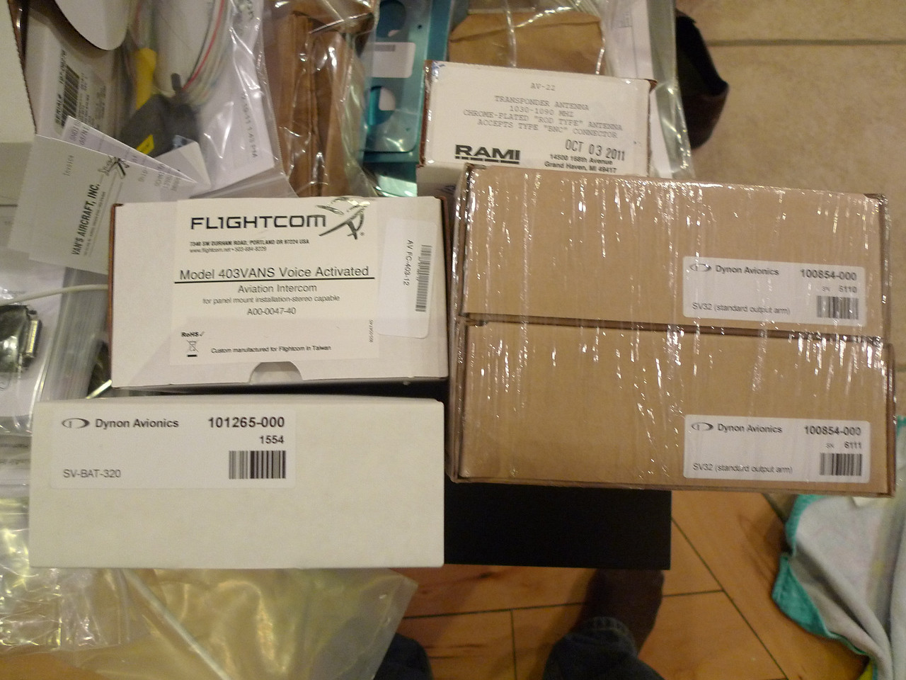

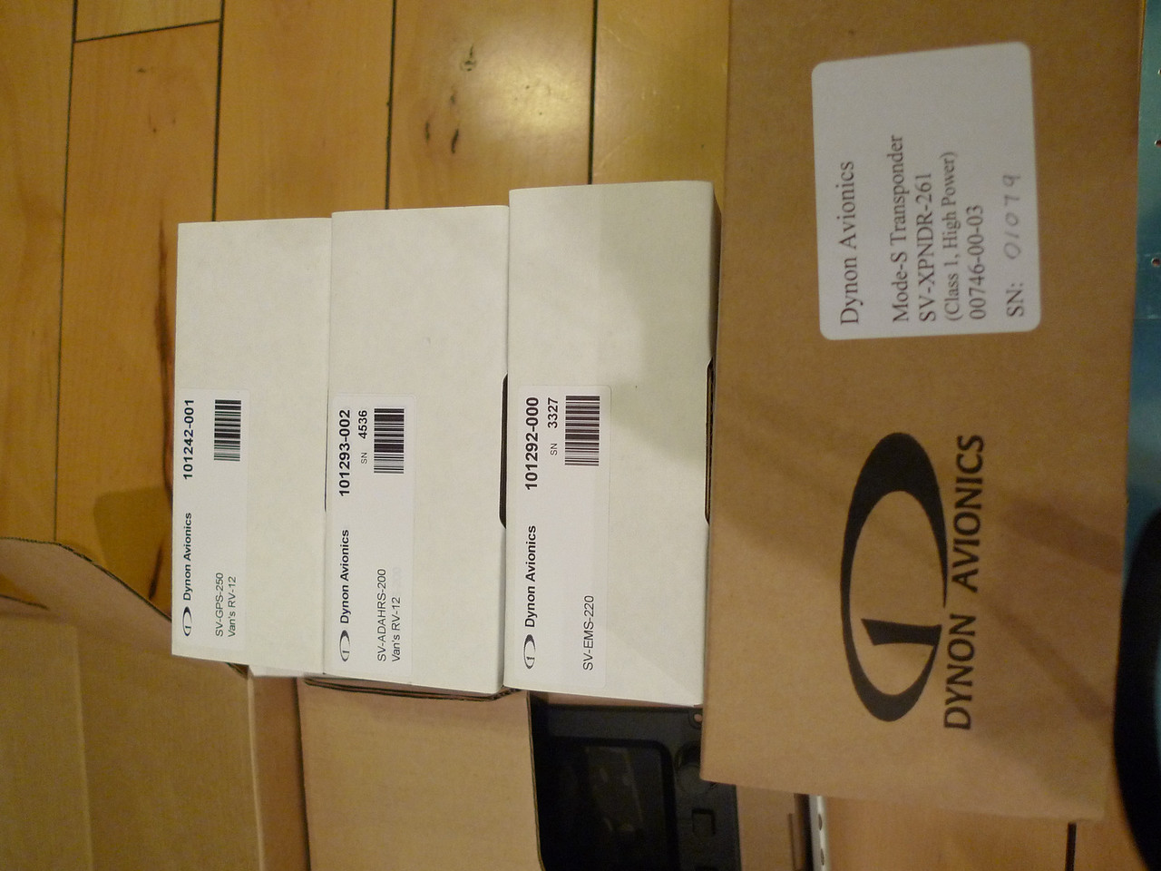

We got ours tonight!
Like others, two boxes and a couple back ordered harnesses. Wow, what a complete kit with great quality from what I can tell. You guys have no idea how nice it is to receive something like this. I spent months working on my panel for the RV-10 which included planning, ordering, wiring, ect.......
It was a long wait for the Skyview but like everything Van's does, it looks like it was done right and is very complete.
I remember the early RV-4 guys saying how spoiled I was with a pre-punched RV-10 kit. Now I am telling all you RV-12 guys that you are completely spoiled with this kit. I've said this before, "It practically builds itself!"
Here are a few pictures. Luckily I had some help from Anna.
More Pictures
Looks like it is pre-wired for ADS-B
Nice, thick manual
Just an idea of the quality of the connectors
Let me know if anyone wants a specific picture of something.

I'll be back at work on the plane on Friday. Time to run the two new harnesses and the replacement wires to the tailcone. I'll report on that. The wire spoon looks like a great idea - and I think I can make a serviceable one for free using a piece of stiff plastic tubing cut at an acute angle. I'll post how it goes. Then it is "plug it all in" - finish the engine hookup, mount the prop and (gulp) first engine start!
Skyview Intercom Wires
AN UPDATE
Earlier, I received word from Van's regarding the Skyview question: "Where do we connect the intercom wires? The plans only show adapting from a cable that you would have gotten only if you bought the original avionics."
Here's what they said: "As suspected, the headset wires need to be plugged into the AV-5000. However ---- they won't reach, and you will need an extension - also there are 7 places in the connector on the AV5000, and you have 8 wires, the two ground wires need to be spliced together.
Bottom line, we will need to make some harness adapters for you guys (about 190 customers) who have the old fuse wiring . Our engineering guys are working on this, but it will take a couple of weeks to get them made and sent out to you."
Then I went out and checked and it looks to me like my wires are long enough to reach. I sent them a picture and requested the pinouts.
They noted to me that the pins on the existing harness are male and have to be changed to female. I noted that I had female pins and a crimper.
They then provided this guidance below. But I think they still intend to send out adapter harnesses.
Per Vans:
The headset wires plug into the "Options" harness WH-00045
Pilot headphone
White L - Pin 28
Blue/WHite R - Pin 29
Pilot Mic Wht/Orange Pin 27
Co-Pilot headphone
White L - Pin 24
Blu/Wht R - Pin 25
Co-Pilot Mic Wht/Orng Pin 26
Both the green Audio Grounds/shields need to be spliced together and go to
Pin 37
NOTE: This is the panel end of the shielded wire so the shield does get crimped to the wire & pin on that end. Normally the instructions have us dealing with the other end of the wire for which the shield is not attached to anything.
