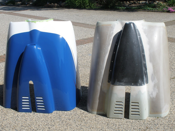

My airplane has hinges between the upper and lower cowls and vertical hinges that hold the lower cowl to the firewall. It's getting camloks around the top rear cowl at the firewall and three camloks underneath the lower rear cowl on each side of the air exit.
