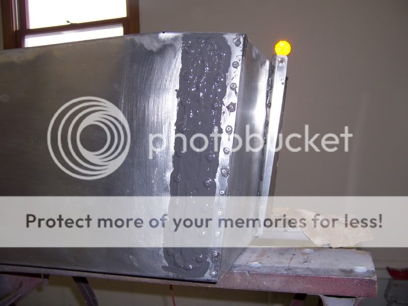

Fuel tank leak test
I waited untill I received the new window and backup plate and used them to complete my tank. I mounted the tank to a couple of pieces of wood so the tank is supported as it would be in the airplane. My mentor, Jan, suggested we put in put in 1 gallon of 100LL and run it around all the tank seams and screws to see if we had any leaks. One screw on the fuel gage plate leaked so I removed the screw, re-prepped the area and installed a new screw with ample amounts of proseal. After a week we ran the 1 gallon of fuel around the seams and screws and no leaks were observed. We then put in 19 more gallons of 100LL. Jan suggested that we use the 100LL instead of mogas because the coloring in the 100LL will leave a stain that we could see for any weeping or very slow leaks. The tank has been setting in the hangar for a week and I don't see any leaks. I plan to leave the gas in the tank until I need to install it for flying. Current guess for flying is about 3 months away due to building interruptions for holidays and skiing.

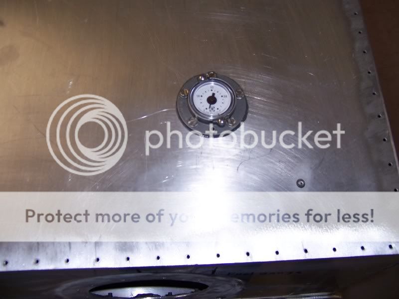

Mine ( original design ) cracked and started leaking. I decided to eliminate the window. We have ethanol in this area, and I just am not sure it won't be a problem in the future. I think the factory 'fix' is a serious improvement over the original design, but I don't want to take a chance. If you want more details, ask.
I can turn around and see this gauge WHILE FLYING. Also, while filling, you can see this. All these things together made me change it.
John Bender
John's Fuel Guage
Another advantage of John's guage is that you can see how much is in the tank as you fill it, so you don't overfill and wind up with gas running all over the outside of the fuse.

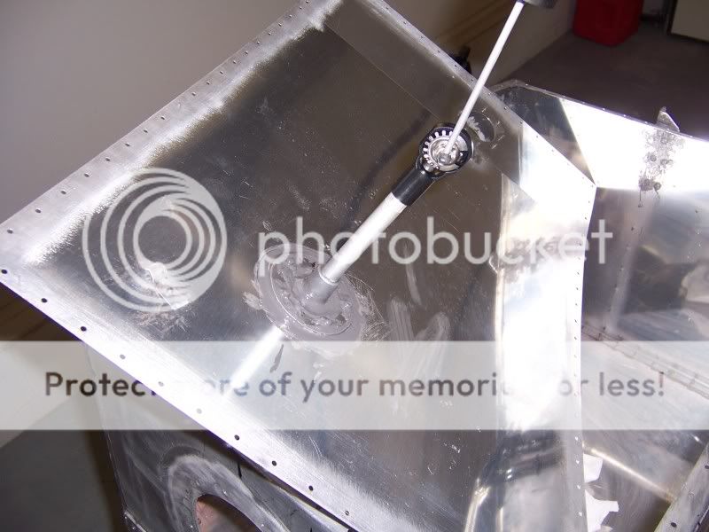

Old material: problems. We had installed the tank in the aircraft with no leaks. After filling the tank with 20 gallons of fuel the plastic cracked and leaked. We now have covered the old sight holes with a .040 plate and pookied up the tank. We also installed a Moeller mechanical fuel gage on the top of the tank. We have leak checked the tank and will install it this week and recalibrate with 20 gallons of fuel. I sure hope the leak problem is fixed!
