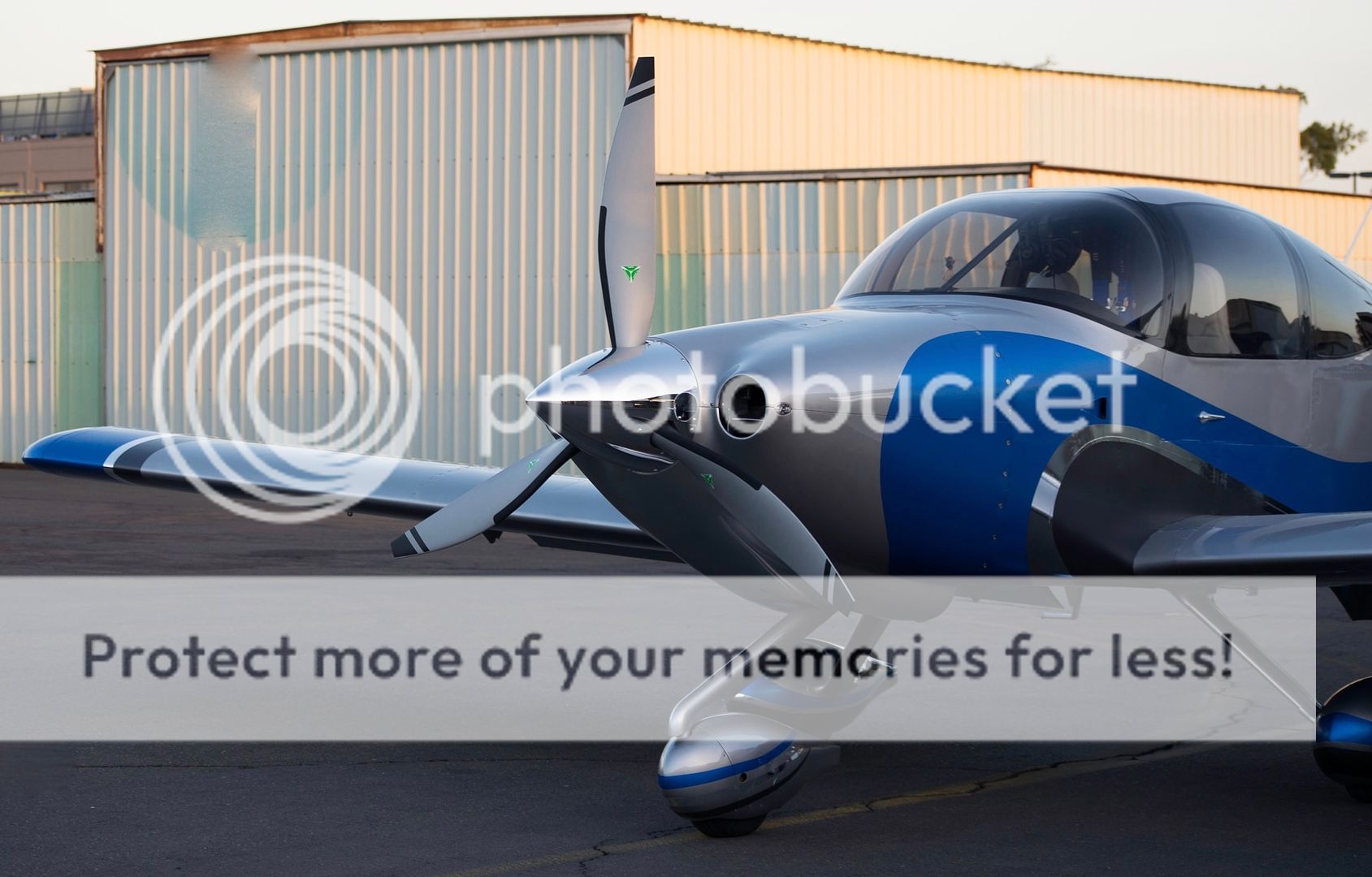

If you haven't purchased your prop, the MT prop includes the spinner. The hartzell does not include the spinner and it costs about $1200.
I talked with Bryan at ShowPlanes quite a bit. I am using a Barrett 540 with Cold Air Induction, Full Dual EFII, and the MT Prop (probably NOT an MT governor!). I purchased the induction system as well. The induction system is available for the FM-200 or FM-300 servos. The EFII uses the FM-200 system but needs to extended as the EFII throttle body is shorter.
Bryan asked which alternator I was using. Alternators with the B lead on the side will probably need a bit of massaging on the induction system. I will be using the B&C unit, so no issues there.
I spoke at length with Bryan about using a plenum. He said it would probably work but that he hasn't found the need to use one as all temps were well within limits.
The cowl looks great and the f/g work is excellent. It cost $1950. The induction was $600. $75 to crate it. It cost $276 to ship from OR to IN.
I like the fact that it does not have "the snorkel" and does not use the Van's FAB unit.
