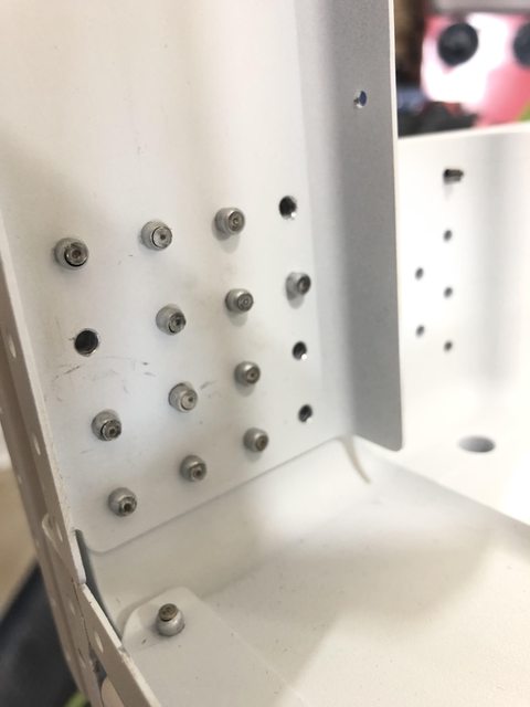

Well, I just got to this part of the 12iS fuse build, and just let me say, #&@$! Cherry Max rivets.
Like others, this is what I got in return for my lubrication efforts:
Switching from the pneumatic to a slow manual pull helped a little, but still not perfect.
Is there any reason we can't finish setting the ^%$! things with a squeezer? For that matter, can't we just use squeezed rivets in the first place?

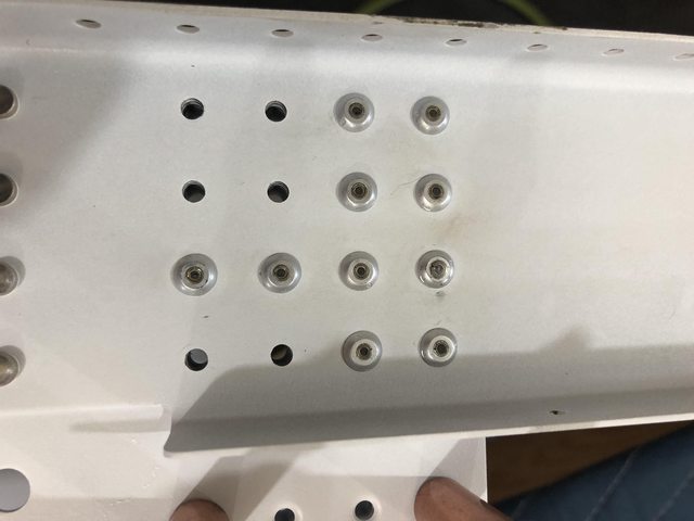

Here's what they look like after a good post-pop squeeze, back and front. Are they good, or do they need replaced?
The good news is that the ones that aren't fully set are trivially easy to remove - you can easily drive out the mandrel and then drill the center of the rivet to remove the manufactured head/punch out shaft. Trying to get a fully set one out teaches you very quickly WHY they are stronger than regular rivets.
Well the ones in the bottom row weren't supposed to be there, which I realized after running short of rivets lol, so I will learn right now just how much pain I'm in store for.![]()
