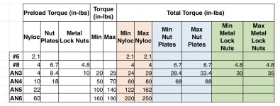

What are the torque specs for the (8) Hinge Brackets bolts?
I can't find it - where's it listed?
Does anyone use Loctite?
Also torque specs on the (2) Hinge Bolts?
See KAI Section 5.20 for torque values. For AN4 bolts in nut plates, I add 18 lb-in to account for nut-plate friction. That’s just what I measured with new hardware when testing during my build. You can test yourself, as used hardware results will like vary.

See KAI Section 5.20 for torque values. For AN4 bolts in nut plates, I add 18 lb-ft to account for nut-plate friction. That’s just what I measured with new hardware when testing during my build. You can test yourself, as used hardware results will like vary.
Inch pounds? :confused:
So, see if I got this right below............
(8) AN3-4A bolts into (8) K1000-3 nut plates
Torque - 18 inch lb + 20-25 (standard nut) = 43 max torque
AND
(2) AN4-12A bolts into (2) K1000-4 nut plates
Torque - 18 inch lbs + 50-70 (standard nut) = 88 max torque
I will verify my 18 inch lb drag which may vary.
Thanks for the help......
No, the AN3 will have a lower value. I measured 8.4 lb-in in nut plates in my testing. Here’s the chart I created during my build. Again, with new hardware, but not sure how much difference you’ll get.
Great chart Bob - that helps a lot!
I'll use torque seal - did you use any loctite on the threads?
Torque seal, yes; Loctite, no. I might be wrong, but believe adding Loctite to the threads would make them lubricated joints, thus requiring a different torque range. At least as an electrical guy that was my assumption. And since this is locking hardware, didn’t see the need. Plus the fact Van’s doesn’t call for it in the KAIs.
