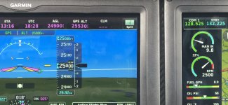

FL250 although conditions were perfect. Light weight (solo, no cargo, 25g fuel), no traffic, low ISA, high to low pressure, 50k tailwinds, smooth air. IAS-100k, TAS-150k, GS-200k. Climb rate was an anemic 100fpm, the definition of service ceiling. Stock engine, 2 mags.
It was only worth it for the tailwinds and to see if it would work.You are a speed bump above FL 180. Need to use the mask which is not as comfortable as the cannula.
