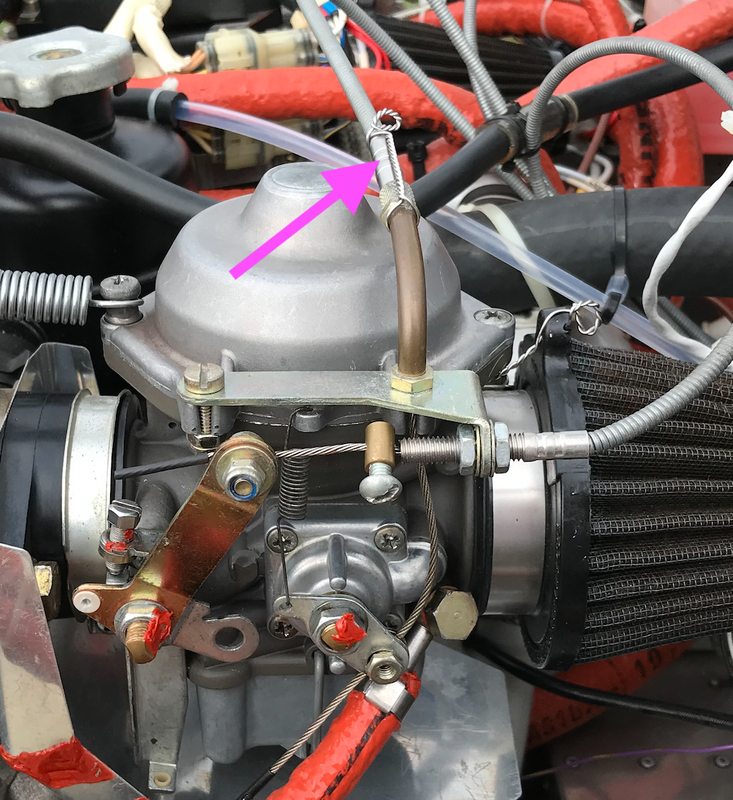

I am already on the hook for a new enrichment cable assy from Van's. I've bought and changed out many a stranded cable and housing on my mountain bikes. Buying the whole Assy is a bit of a shocker.
Seems someone didn't bother to leave either an inch, or crimp a lead bullet cap on the end to prevent stranding of the cable as called out in section 50-1 of the KAI.
The lock nut wasn't even butted tight up against the stop, and the unit was completely un threaded, out of even having any adjustment, to get some enrichment on the right Bing Carb.
Baby steps, Scott, baby steps, I still have to pay an instructor for lessons, too. :D
When replacing enrichment cable, you need to safety wire the end of the sheath where it enters the sweeping elbow at the carb. Because the cable gets so slack when enricher is shut off the sheath can back out of the cup on the elbow and then prevent full motion of the cable. Thin safety wire works best in this application.
Noted, also going to witness paint those nuts on the shaft of the Carb throttle and enrichment devices.
A good example of where a picture is worth 1000 words. I am a much better visual learner, than written.
I can see why it would be needed in the installation shown in the photo.
There is too much slack in the cable so the cable housing would easily come out of the barrel adjuster.
I have never seen the housing come out of the barrel if the cables are adjusted properly.
I would sooner leave a little slack in the cable, and tie off with safety wire, than cinch it tight, have in excess of 1 inch of cable coming out of the clamp, and then cutting the excess end off of the cable and fraying it to bits, and the cable starts slipping, due to fraying.
Which is what the previous owner has put me in, position wise. A very expensive mistake, over something very, very simple, even a repair technician in a bicycle shop knows this. Put heat shrink on those ends, or a lead cap you can crimp on, everyone!
I don't know if Van's sells the cables with crimp on lead caps, if they don't, the prebuilt cables should come with those items in the cable kit.
I think best to leave this cable with extra slack. The return spring for the enricher arm is very weak. You don't want to have enricher circuit happening during normal ops. Safety wire the sheath / elbow and you'll be fine.
That is more than just a little slack.
It is far more important for the two sides to be in sync with each other. With that much slack it makes it much more difficult to do that.
All that is needed is just enough slack to allow the cable to be wiggled very slightly when the enrichment control is fully turned off.
